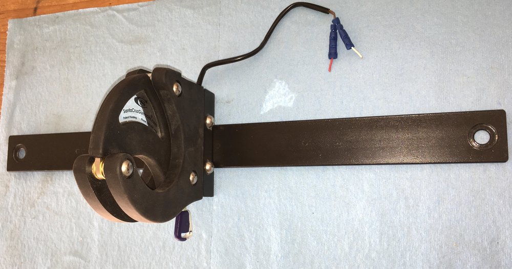

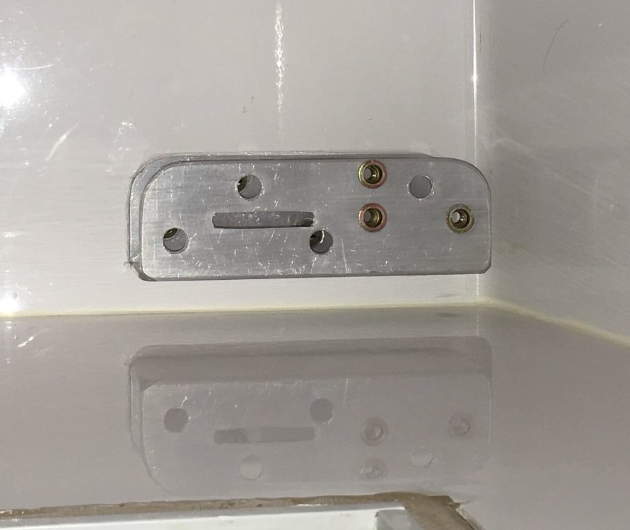

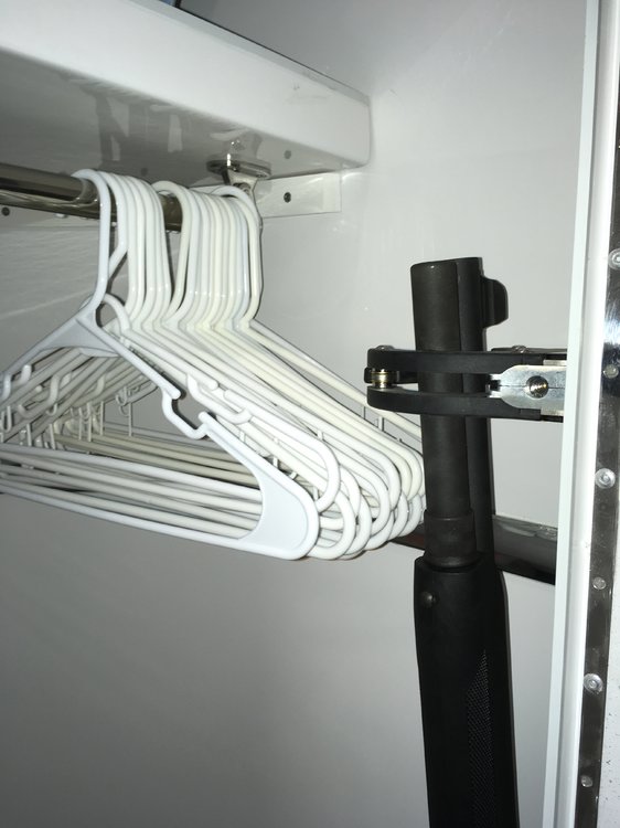

John E Davies Posted June 12, 2017 Author Share Posted June 12, 2017 Electrical Installation: I needed 12 volts to run the circuit. I decided to use the closet LED light circuit since it was directly overhead. By switching on the closet light, using the switch near the microwave oven, the lock is "enabled" or armed. The lock is controlled by a momentary (spring loaded OFF) toggle switch. I found a sturdy and high quality switch at Ace Hardware - it is intended for cabinet door actuation (internal lighting). Cost was $10: Added to the circuit is a 10 second solid state timer. When the switch is toggled up, the timer powers the solenoid, releasing the arm. After ten seconds it automatically resets. It also has a failsafe design: if the switch fails (shorts) the timer will deactivate itself until the switch is replaced, protecting the solenoid. The timer also came from Santa Cruz. It was originally installed in my home closet. Here are all the bits hanging down from the closet light opening: The LED light, a very nice little unit! It was held on with two 1/8 inch aluminum pop rivets which I drilled out. I used small stainless screws for reassembly.: I used a 20 AWG inline fuse holder, which goes above the ceiling panel. I used a 3 amp fuse. Because the color coding was every which way, I labelled the gun wires + and - : All splices were done using regular crimp connectors, and the wires were covered either with heat shrink tubing or spiral wrap. I used 3M mounting tape to secure the timer to the ceiling. The finished installation: Closeup of the timer unit: Wiring schematic: ... http://ledguy.net/santa-cruz/pdf/Timer.pdf I ran the two shrink wrapped wires for the gun lock solenoid down inside the exposed channel of the door frame. I secured them there with dabs of silicone sealer every few inches. I added self stick nylon wire tie anchors at top, to finish it off professionally: Operation: The shotgun is a Mossberg 930 SPX (Special Purpose), with a 20 inch Cylinder bore barrel (no choke). It's very well built and reasonably affordable, and a great choice for a home or trailer defense weapon, agains humans, moose, bears or rabid coyotes. The semi-auto action reduces the brutal kick of a 12 gauge, a little ;) My bear load is Brenneke Black Magic 3 inch magnum slugs. They are hardened so that they will penetrate deeply without slowing down. There is even a picture of an angry brown bear on the box;) They are Big Medicine, but they hurt your shoulder, a lot. To secure the gun, place the butt into the saddle, maneuver the barrel and mag tube into the open arm of the lock. Squeeze the arm closed while wiggling the barrel to eliminate any play. It click click clicks and locks into place. To retrieve the gun, the closet light must be switched ON. Reach up past the stereo speaker and flip the toggle switch straight up. The timer activates the solenoid, the lock arm is freed and you can remove the gun. If you do nothing within 10 seconds, it will re-lock itself. Cool! The shotgun clears all the coat hangers by a good margin. There is enough clearance, toward the outside of the trailer, to mount a scoped rifle. There is about 8 inches of vertical adjustment in the lock, in both directions, to allow for different stock and barrel lengths. When locked, it is possible for someone to lift the butt up and out of the saddle, but it is impossible to get the barrel out of the lock assembly: the front sight prevents that. A shotgun with no front sight would require a different setup. The mount is not fully burglar proof, nor is it intended to be. It is intended to be handy and quick to access, and secure in terms of an unsupervised child or thief with minimal time to hammer and pry on the parts. With a towel or shirt draped over the muzzle and lock, it looks completely innocuous. Transport laws vary widely: some states allow you to transport a loaded, but secured, long gun, others require you to unload it and place the ammo in a separate container. Sometimes, it has to be a locked container, in a separate area. Always check local and state laws before transporting any firearm! This setup is fully legal to bring across the border into Canada, if declared ahead of time and the fee is paid, eh! This thread was a LOT of work, thanks very much for reading. John Davies Spokane WA 1 "Mouse": 2017 Legacy Elite II NARV (Not An RV) Two Beds, Hull Number 218, See my HOW TO threads: https://olivertraveltrailers.com/topic/john-e-davies-how-to-threads-and-tech-articles-links/ Tow Vehicle: 2013 Land Cruiser 200, 33" LT tires, airbags, Safari snorkel. Link to comment Share on other sites More sharing options...

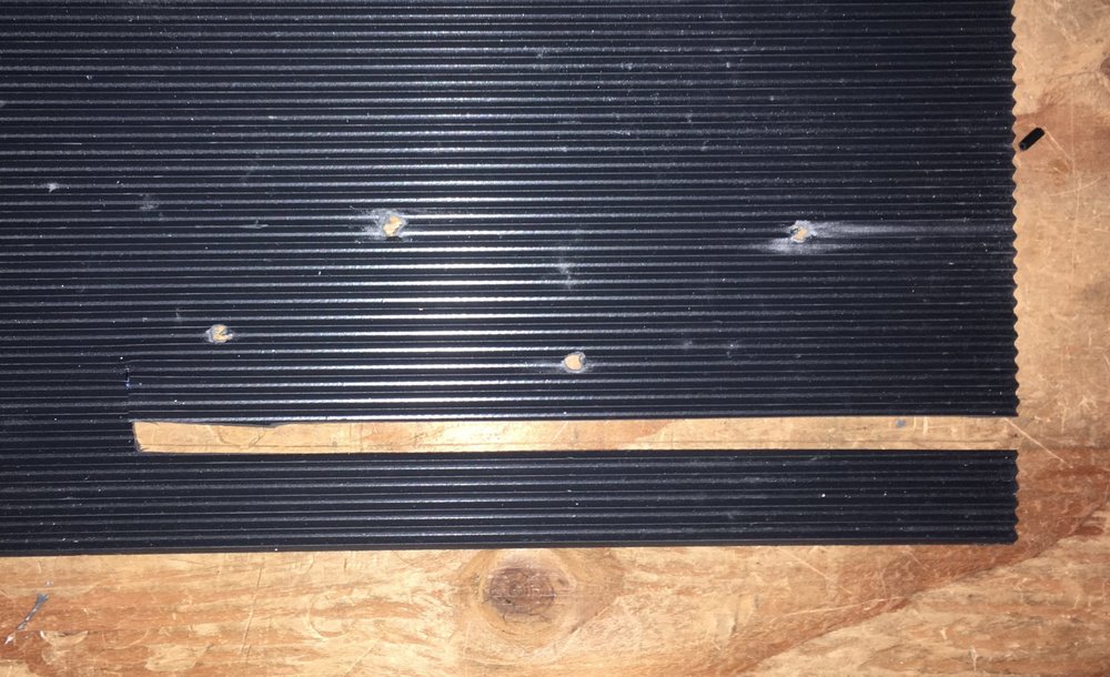

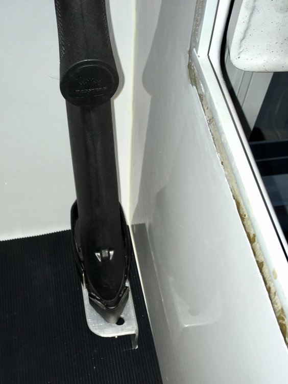

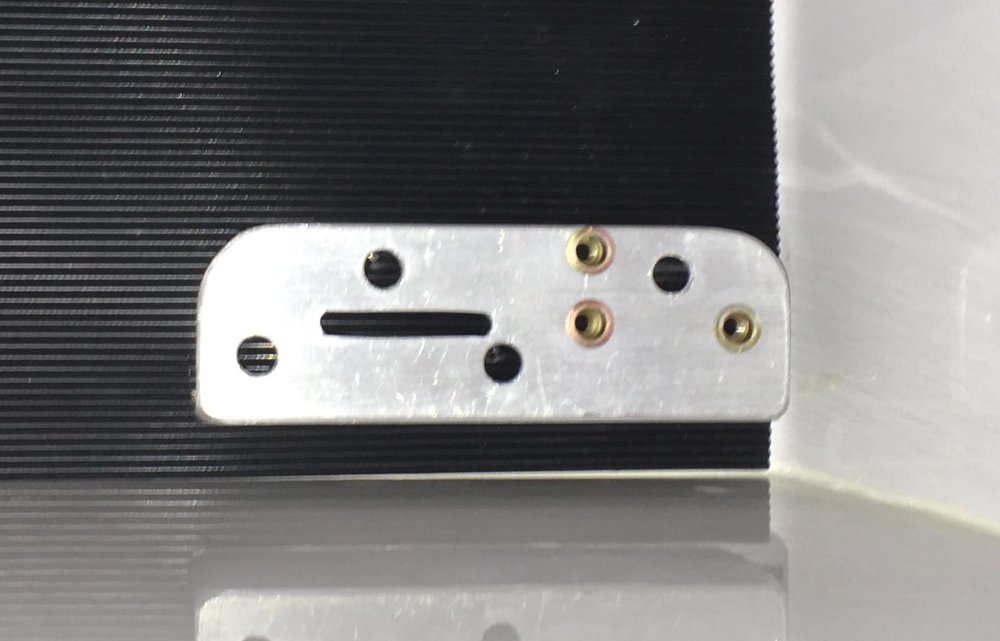

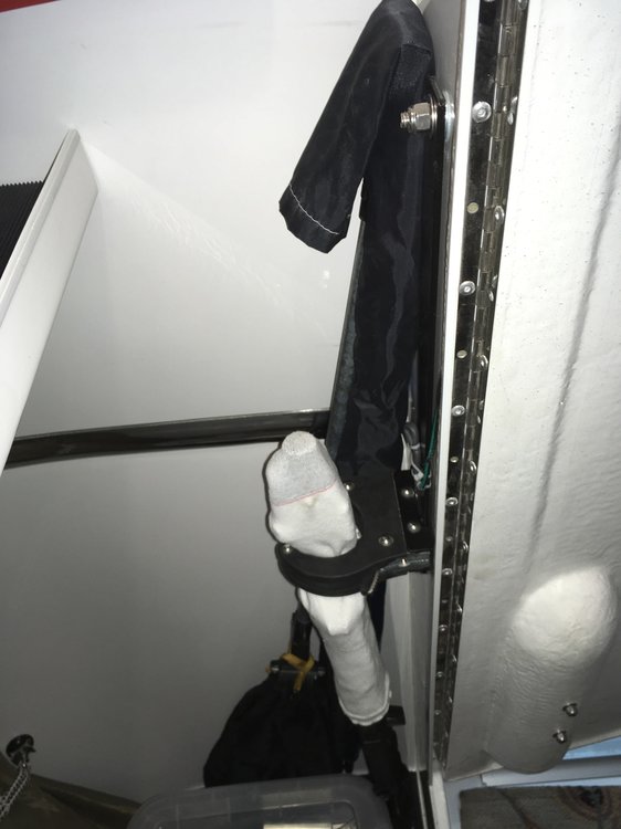

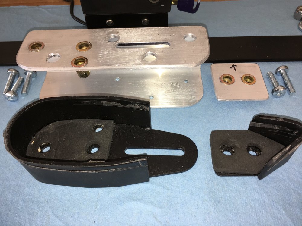

John E Davies Posted November 17, 2018 Author Share Posted November 17, 2018 I received a PM asking about this mod, and I realized that the forum had lost a ton of the pictures I uploaded. Also I cannot edit my first post, so I am just going to replace the lost pics here. If there are any specific questions please ask for clarification. 1 "Mouse": 2017 Legacy Elite II NARV (Not An RV) Two Beds, Hull Number 218, See my HOW TO threads: https://olivertraveltrailers.com/topic/john-e-davies-how-to-threads-and-tech-articles-links/ Tow Vehicle: 2013 Land Cruiser 200, 33" LT tires, airbags, Safari snorkel. Link to comment Share on other sites More sharing options...
John E Davies Posted November 17, 2018 Author Share Posted November 17, 2018 More "Mouse": 2017 Legacy Elite II NARV (Not An RV) Two Beds, Hull Number 218, See my HOW TO threads: https://olivertraveltrailers.com/topic/john-e-davies-how-to-threads-and-tech-articles-links/ Tow Vehicle: 2013 Land Cruiser 200, 33" LT tires, airbags, Safari snorkel. Link to comment Share on other sites More sharing options...
John E Davies Posted November 17, 2018 Author Share Posted November 17, 2018 More pictures. "Mouse": 2017 Legacy Elite II NARV (Not An RV) Two Beds, Hull Number 218, See my HOW TO threads: https://olivertraveltrailers.com/topic/john-e-davies-how-to-threads-and-tech-articles-links/ Tow Vehicle: 2013 Land Cruiser 200, 33" LT tires, airbags, Safari snorkel. Link to comment Share on other sites More sharing options...
John E Davies Posted November 17, 2018 Author Share Posted November 17, 2018 Weird. I reposted the pictures here at the end, and they reappeared in the original first post by digital magic. I hope they stay there. John Davies Spokane WA "Mouse": 2017 Legacy Elite II NARV (Not An RV) Two Beds, Hull Number 218, See my HOW TO threads: https://olivertraveltrailers.com/topic/john-e-davies-how-to-threads-and-tech-articles-links/ Tow Vehicle: 2013 Land Cruiser 200, 33" LT tires, airbags, Safari snorkel. Link to comment Share on other sites More sharing options...
John E Davies Posted March 26, 2019 Author Share Posted March 26, 2019 Sold my 12 gauge shotgun, it was just getting too brutal for my aging joints.... I readjusted the barrel clamp a little lower and mounted my Kel-Tec SU16C 5.56 carbine. It has a tactical light clamped onto the end - I was able to adjust it and the clamp so that everything fits and the switch at the rear of the light is well protected. There is still lots of room behind it for the telescoping leaf rake, kite and a brolly. And here it is ready to travel with an old sock over the business end to keep out spiders and make it less noticeable. Unlike the shotgun, I can’t bring that carbine into Canada, but I can figure out something legal if I ever actually go there.... my last trip was in 1988.... ;) John Davies Spokane WA "Mouse": 2017 Legacy Elite II NARV (Not An RV) Two Beds, Hull Number 218, See my HOW TO threads: https://olivertraveltrailers.com/topic/john-e-davies-how-to-threads-and-tech-articles-links/ Tow Vehicle: 2013 Land Cruiser 200, 33" LT tires, airbags, Safari snorkel. Link to comment Share on other sites More sharing options...

John E Davies Posted July 5, 2020 Author Share Posted July 5, 2020 (edited) The rack works fine with my Henry lever action rifle. This is the new Big Boy X model in .44 Mag with 17.2" threaded barrel, side loading gate and plastic stock. I had to lower the clamp all the way to the bottom of the track. The rifle is less noticeable, and the muzzle is protected, with a sock. When the rack is full of hangered clothes it is really not very obvious. Sorry for the out of focus pic: John Davies Spokane WA Edited July 6, 2020 by John E Davies 1 "Mouse": 2017 Legacy Elite II NARV (Not An RV) Two Beds, Hull Number 218, See my HOW TO threads: https://olivertraveltrailers.com/topic/john-e-davies-how-to-threads-and-tech-articles-links/ Tow Vehicle: 2013 Land Cruiser 200, 33" LT tires, airbags, Safari snorkel. Link to comment Share on other sites More sharing options...
