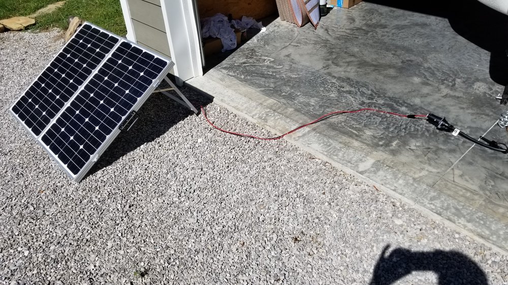

KountryKamper Posted May 1, 2019 Share Posted May 1, 2019 You can also change the plug on a portable solar panel to a 7 pin female plug and wire it to the charge and ground lines. Then you just plug the portable solar panel into the trailers 7 pin plug and your charging on solar. No it does not work while driving but we run the fridge on propane while driving and let the truck charge the trailer. I have done it this way for many years now and never found a need for a separate solar port. 1 Tom & Cheryl LE II #305 2018 GMC 2500HD SLT Duramax Link to comment Share on other sites More sharing options...
Moderators SeaDawg Posted May 1, 2019 Moderators Share Posted May 1, 2019 You can also change the plug on a portable solar panel to a 7 pin female plug and wire it to the charge and ground lines. Then you just plug the portable solar panel into the trailers 7 pin plug and your charging on solar. No it does not work while driving but we run the fridge on propane while driving and let the truck charge the trailer. I have done it this way for many years now and never found a need for a separate solar port. Interesting idea. I've not seen it before, but makes sense. Heavy dc wire from 7 pin to battery. I'm assuming there is an inline fuse, somewhere? Never looked. 1 2008 Ram 1500 4 × 4 2008 Oliver Elite, Hull #12 Florida and Western North Carolina, or wherever the truck goes.... 400 watts solar. Dc compressor fridge. No inverter. 2 x 105 ah agm batteries . Life is good. Link to comment Share on other sites More sharing options...

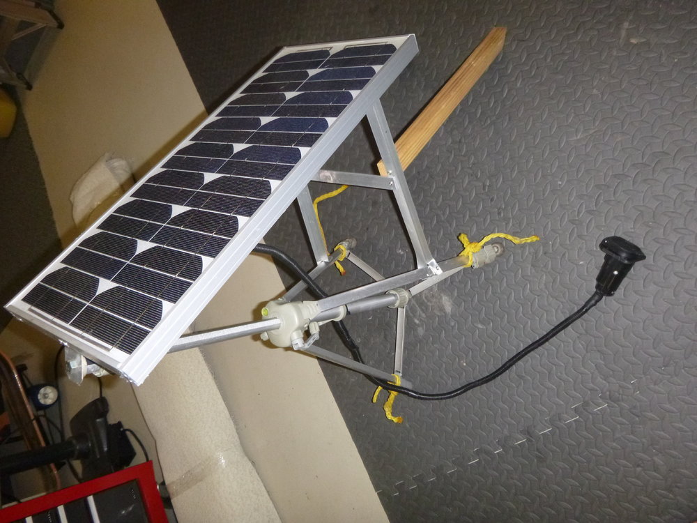

Moderators topgun2 Posted May 2, 2019 Moderators Share Posted May 2, 2019 I thought that I had posted pictures of this solar panel previously. I use it for winter storage (25 watts) and received it in trade from another Forum member. It has the 7 pin connector and it is really easy to install. Bill 2023 Ford F150 Lariat 3.5EB FX4 Max Towing, Max Payload, 2016 Oliver Elite II - Hull #117 "Twist" Link to comment Share on other sites More sharing options...
KountryKamper Posted May 2, 2019 Share Posted May 2, 2019 Here is ours hooked up to our Escape at the house. You can buy the plug if you don't want to make one. https://www.amazon.com/Go-Power-Trailer-Accessory-Portable/dp/B00FYUCQXK/ref=asc_df_B00FYUCQXK/?tag=hyprod-20&linkCode=df0&hvadid=241895364904&hvpos=1o3&hvnetw=g&hvrand=18148374487848260269&hvpone=&hvptwo=&hvqmt=&hvdev=m&hvdvcmdl=&hvlocint=&hvlocphy=9013674&hvtargid=pla-556581978378&psc=1 Tom & Cheryl LE II #305 2018 GMC 2500HD SLT Duramax Link to comment Share on other sites More sharing options...
