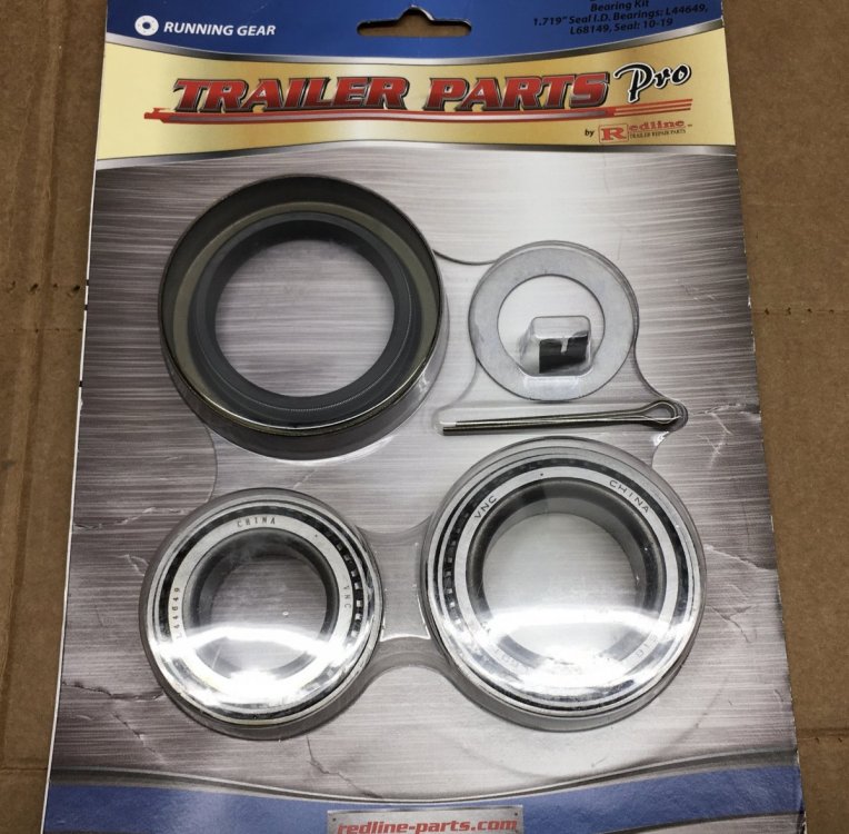

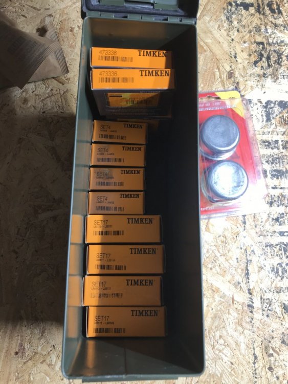

Townesw Posted March 7, 2020 Share Posted March 7, 2020 (edited) I service my own bearings. I ordered enough USA made Timken bearings and seals to do all 4 hubs twice. The Timken bearing sets were individually packaged in a sealed plastic wrap inside a box unlike the Chinese bearings I see usually loose in a clamshell blister pack. I agree with BackofBeyond, the bearings themselves look much better than Chinese bearings. I replaced the original bearings and seals at 6000 miles with USA made Timkens. I put the other 4 sets, along with a couple of extra hub caps and 2 packs of desiccant in a 30 cal ammo can. Before I service bearings again I will order 4 more complete sets to have on hand. When I service a hub I have to use a new seal, so all all I’m saving by cleaning and repacking all of the used bearings is about $44, so I just go ahead and use new bearings and seals on all 4 hubs. I removed the wheel centers from all 4 wheels. I check the hub temps by hand or non-contact thermometer when I stop after having been running at speed for a while. I can also adjust bearing play if necessary without having to remove the tire/wheel assembly and then go through the complete wheel nut re-torque procedure. I installed Dill TPMS sensors inside each tire. The Dill system displays the pressure and temperature inside each tire. Whoever is riding co-pilot occasionally checks the Dill display to see if a tire is running a pressure much lower than the rest or a temperature much higher than the rest. It’s interesting to watch the pressure and temperature vary due to ambient air temperature, speed, road surface, wet or dry pavement, location of the sun, etc. https://www.dillvalves.com/wp-content/uploads/2019/09/Trailer-TPMS-Catalog-Page.pdf Well that’s enough rambling. I guess I should have just said that I agree with BackofBeyond regarding USA vs. Chinese bearings 😜. Edited March 7, 2020 by Townesw Additional pontification 1 Bill and Martha 2018 LEII Hull 313 2019 Chevrolet 2500HD Duramax Link to comment Share on other sites More sharing options...

Townesw Posted March 7, 2020 Share Posted March 7, 2020 John I didn’t save a link to where I bought these bearings, but they were packaged just like other Timken bearings I have handled in the past and they look and feel better than Chinese bearings I have seen and handled. I’m satisfied with them. If I send you my spares will you let me know if these are real or counterfeit? Thanks, Bill Bill and Martha 2018 LEII Hull 313 2019 Chevrolet 2500HD Duramax Link to comment Share on other sites More sharing options...

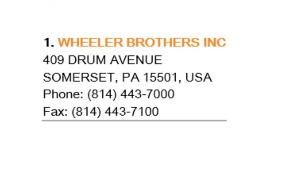

Frank C Posted March 7, 2020 Share Posted March 7, 2020 (edited) Here's a link to Timken. They are well aware of the bogus bearing issue. I'm sure they would be happy to provide info on their authorized distributors. I'm going to contact them to get some authorized east coast distributors. I'll post here if/when they reply. Contact the Company: Program Manager Timken 1835 Dueber Avenue, S.W. Canton, OH 44706 United States (330) 471-6829 https://www.timken.com/contact-general/ Edited March 7, 2020 by FrankC 2019 Oliver Legacy Elite II - Hull #461 Tow Vehicle: 2019 Ford F-250 SuperCab 4x4, 6.2L Flex-Fuel engine Link to comment Share on other sites More sharing options...

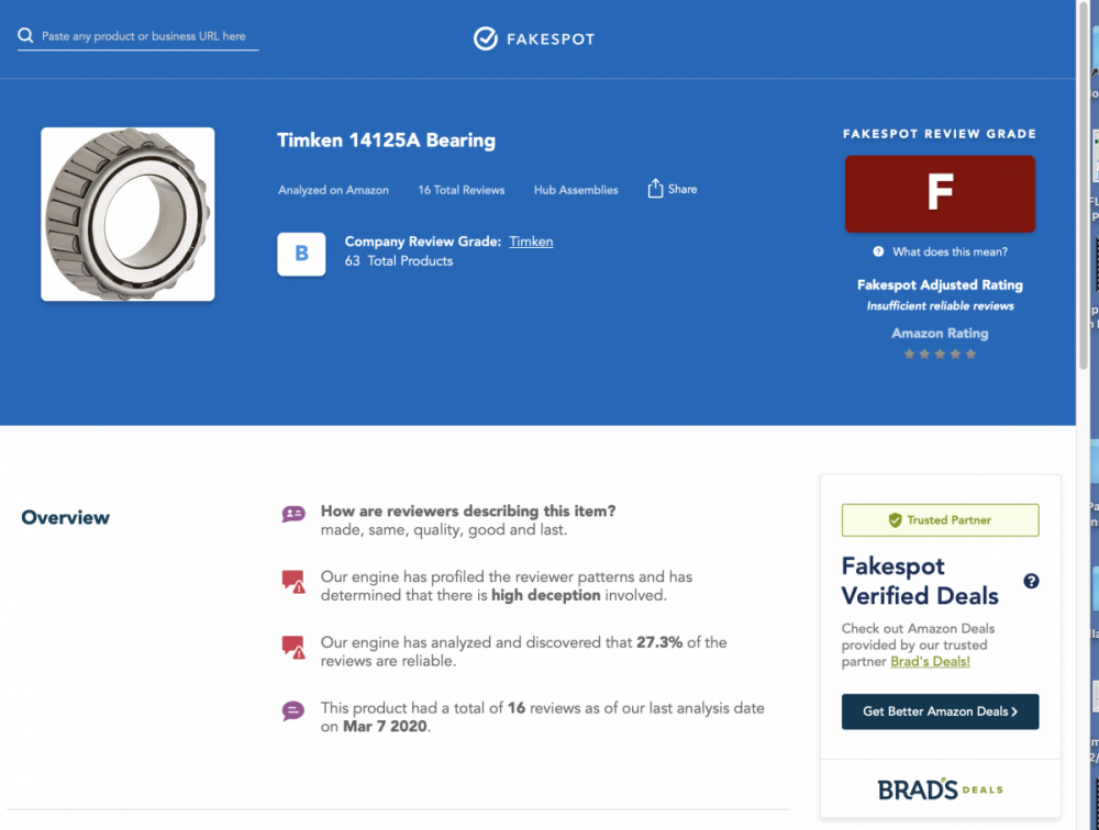

John E Davies Posted March 7, 2020 Share Posted March 7, 2020 It is so very frustrating. I tried the bearing check app and it crashed n my IOS devices. This Amazon ad looks good - the seller is "Timken". So you run it by Fake Spot and get this: You click on the seller "Timken" and all you get is a bunch more bearings, nothing at all about the seller. Who is fake anyway, since the genuine bearings and races are not sold separately. I am 99% sure mine are the real deal, they look correct, with high tech label, and the inner wrapper over oiled parts (but mine do NOT have the QR code - so maybe they are Old Stock?) : I paid $145 for the eight bearing sets, locally at a professional supply house (part of the BDI network). The seals cannot be identified by inspection - they say "National" on the outside, but they are definitely high quality and have the orange sealer material where they go into the race cavity. See interesting video: "Follow the Chinese authorities in a raid against a counterfeit bearing workshop. In this video you can see how low cost bearings are branded to look like high quality premium bearings. Even small scale operations use using sophisticated equipment to mark the products to look like original products. The poor working conditions of the under-age workers are also displayed." Raid on Chinese Counterfeit Bearing Manufacturer I found a dozen or more links about the problem, this is typical: https://rogtecmagazine.com/timken-counterfeit-products-are-a-trap-for-end-users/ So I guess what we should be asking, is "Should I worry about cheap bearings in my Ollie?" My answer is, don't lose sleep over it, but carry a spare set like this and a pound of bearing grease. You may not have the skill or tools to install them out in the boonies, but most likely somebody around you can help. Monitor the hub temperature with a temp gun or a careful finger; a distressed bearing will run hot. This is in my kit, and I wouldn't hesitate to install it to complete a long trip, but I would not INTENTIONALLY replace all my bearings with this kind. If you go far out into the boonies, or way up into Alaska, or are super anal like me, I think you will sleep better knowing you have genuine high quality parts in your hubs. Nobody wants to deal with a blown or melted bearing beside the road... John Davies Spokane WA 1 "Mouse": 2017 Legacy Elite II NARV (Not An RV) Two Beds, Hull Number 218, See my HOW TO threads: https://olivertraveltrailers.com/topic/john-e-davies-how-to-threads-and-tech-articles-links/ Tow Vehicle: 2013 Land Cruiser 200, 33" LT tires, airbags, Safari snorkel. Link to comment Share on other sites More sharing options...

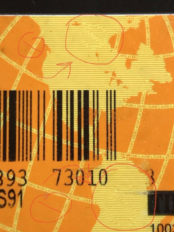

Townesw Posted March 7, 2020 Share Posted March 7, 2020 John, compare these to your boxes. Do they look the same? Also, zoom in real close and see if you have these details on your boxes I couldn’t see them until I zoomed in to read the very small print in the long and lat lines. I bought these June 2019. 1 Bill and Martha 2018 LEII Hull 313 2019 Chevrolet 2500HD Duramax Link to comment Share on other sites More sharing options...

John E Davies Posted March 7, 2020 Share Posted March 7, 2020 (edited) 25 minutes ago, Townesw said: Also, zoom in real close and see if you have these details on your boxes Yes mine have those two very faint circular/ line watermarks (?) as well as teeny weeny "TIMKEN TIMKEN TIMKEN" written along all the Lat/ Log lines. They are so very small I had to use a 10X hand lens to read them - they must be laser engraved because you could not print anything that small that could be read. Here is mine: If this is some fake-proof branding that Timken uses, then I am not surprised that I have never seen it mentioned. Maybe we should not tell the world about this so China does not start doing it ... Good catch! John Davies Spokane WA Edited March 7, 2020 by John E Davies 1 "Mouse": 2017 Legacy Elite II NARV (Not An RV) Two Beds, Hull Number 218, See my HOW TO threads: https://olivertraveltrailers.com/topic/john-e-davies-how-to-threads-and-tech-articles-links/ Tow Vehicle: 2013 Land Cruiser 200, 33" LT tires, airbags, Safari snorkel. Link to comment Share on other sites More sharing options...
