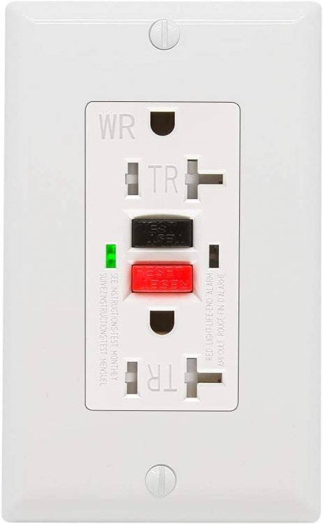

Dean Posted September 2, 2020 Share Posted September 2, 2020 You are looking for an outlet that looks like this Link to comment Share on other sites More sharing options...

John E Davies Posted September 2, 2020 Share Posted September 2, 2020 (edited) Since you are there, go into Walmart and buy a 120 volt outlet tester specific for GFCI testing. Once you get power back, you can check all the outlets for correct wiring and ALSO test the GFCI one to make sure it is not defective. It is common for them to go bad, if so just replace it with a new one. Any GFCI tester is fine, it should look similar to this one with the Test button: Does your inverter power on properly? Does the green light at the wall switch come on? I’m sorry we are all asking this question, but some folks might not know it is necessary.... it doesn’t come on by itself. John Davies Spokane WA Edited September 2, 2020 by John E Davies "Mouse": 2017 Legacy Elite II NARV (Not An RV) Two Beds, Hull Number 218, See my HOW TO threads: https://olivertraveltrailers.com/topic/john-e-davies-how-to-threads-and-tech-articles-links/ Tow Vehicle: 2013 Land Cruiser 200, 33" LT tires, airbags, Safari snorkel. Link to comment Share on other sites More sharing options...

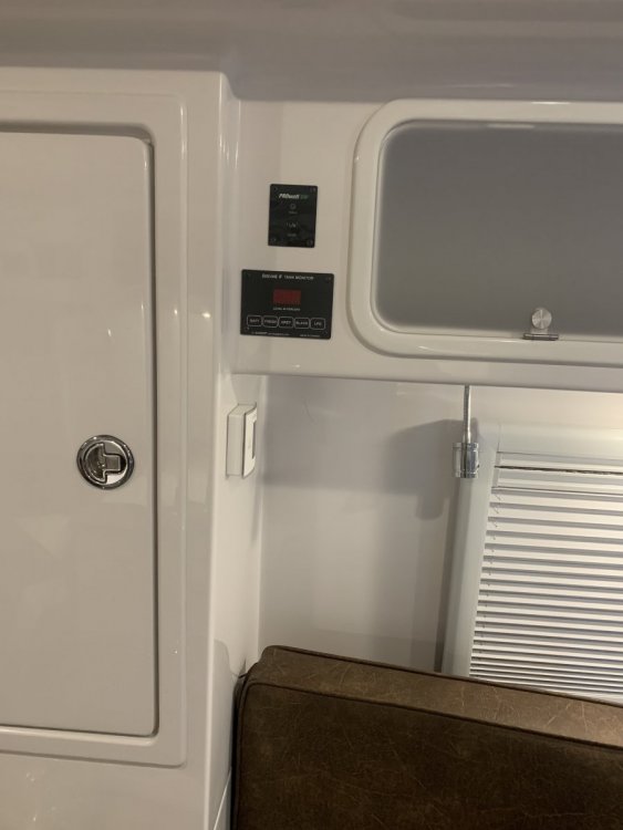

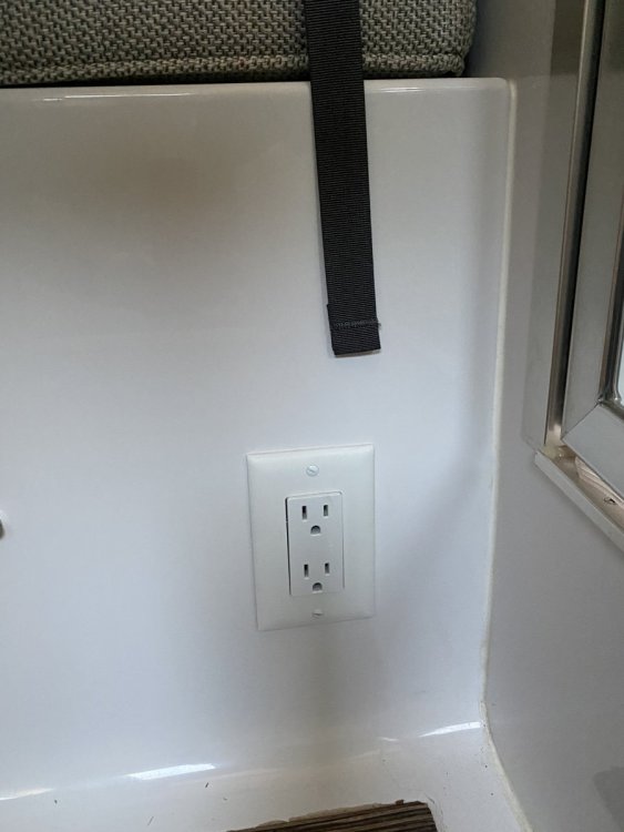

Rodney Posted September 2, 2020 Author Share Posted September 2, 2020 This is the outlet in front of the dinnette. No reset Link to comment Share on other sites More sharing options...
John E Davies Posted September 2, 2020 Share Posted September 2, 2020 (edited) There should be another one under the table, facing toward the back of the trailer, squat down and look there. We need to know your model and hull number. John Davies Spokane WA Edited September 2, 2020 by John E Davies "Mouse": 2017 Legacy Elite II NARV (Not An RV) Two Beds, Hull Number 218, See my HOW TO threads: https://olivertraveltrailers.com/topic/john-e-davies-how-to-threads-and-tech-articles-links/ Tow Vehicle: 2013 Land Cruiser 200, 33" LT tires, airbags, Safari snorkel. Link to comment Share on other sites More sharing options...

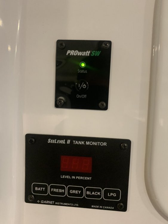

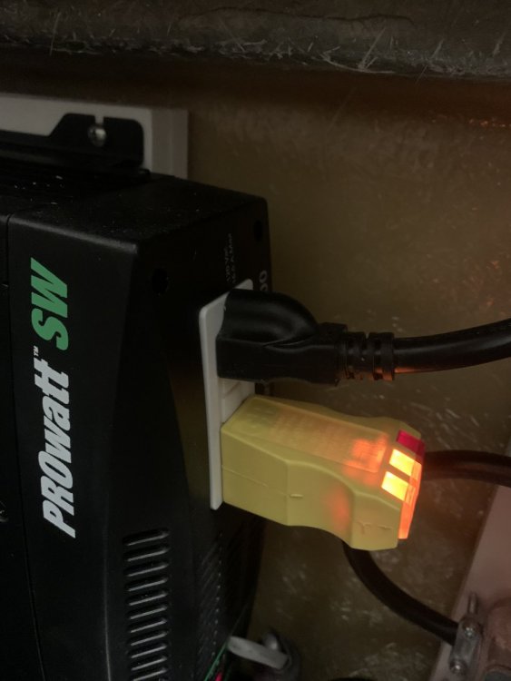

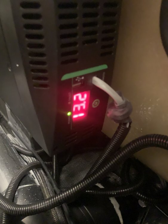

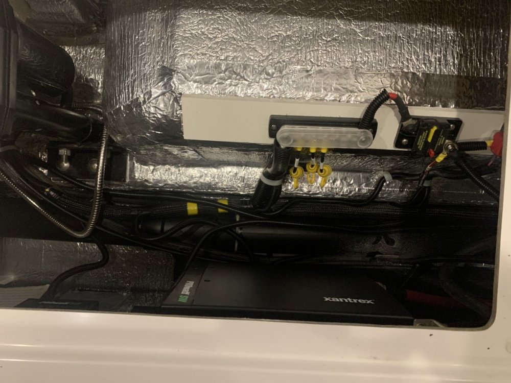

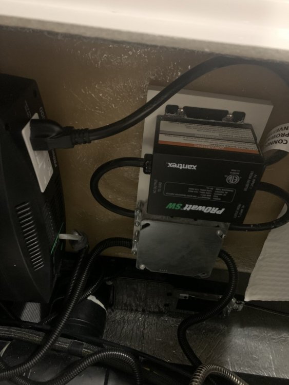

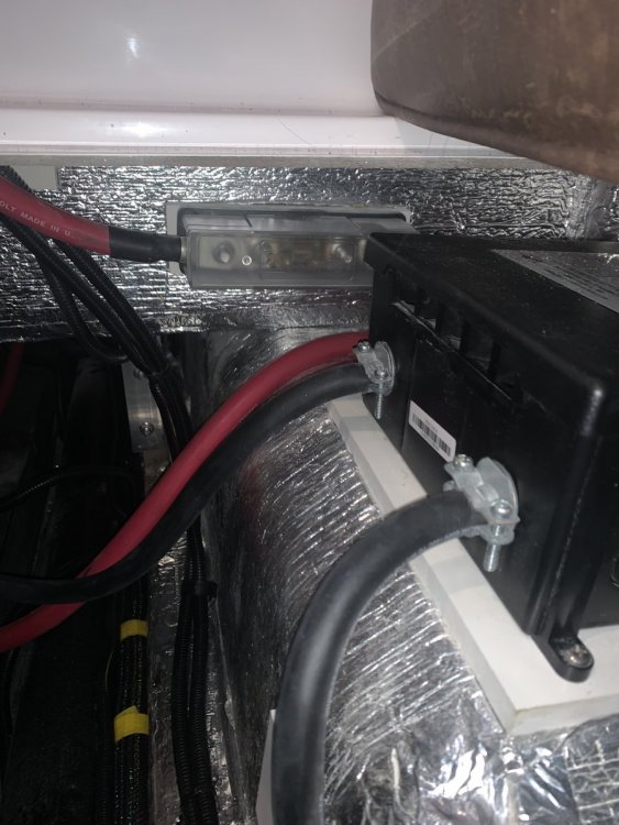

RnA Posted September 6, 2020 Share Posted September 6, 2020 (edited) From past posts, it looks like you may have bought 183? If so, it should have the Xantrex inverter. Some of this has already been suggested but I've added some photos. These come from 365 but it should be close to what you have. Your issue may be as simple as put the ON/OFF switch to the ON position. Don't worry, we've all done it. If it's that, then hopefully these trouble shooting tips will help someone else. If it's more than that, here are some additional things to look at. 1.) Check that the inverter is turned on at remote (green light in "Inverter Power Control Close-up_ON" photo). If the green light will not turn on, proceed to step 3. 2.) Check the power indicator at the bottom/back of the inverter. The indicator should be green and the red led should cycle to show voltage in (see photo "Inverter Control and Power Display"). If power comes on, proceed to step 4. 3.) Turn on inverter at inverter by pressing the green power button next to the LED display (noted above). - If power comes on, re-seat the "phone" cable just above the LED display. This is the cable to the remote power switch in step 1. Proceed to step 2. - If inverter did not turn on, it may have failed or is not getting power. Proceed to step 5. 4.) Check the GFCI outlet on the back of the inverter located under the port side bed (twin models) or port aft dinette seat (standard models). Check that the GFCI is not tripped. (See photos "Inverter Power Outlet_GFCI"). Check power at the outlet by plugging something in. (See "Inverter Power Check") If power is good at the inverter, make sure the 120 volt plug is fully seated and re-seat the plug at the inverter as it feeds other outlets in the trailer. 5.) If you can measure voltage, check for 12 vdc at the inverter. If voltage is good, I would suspect the inverter. If no voltage, trace back to batteries. This will include the large ANC fuse under the forward side dinette (see photo "ANC Inverter Fuse). Be care, these cable can draw a lot of power (see photo "ANC Inverter Fuse" top of photo, fuse block connected to large red cables). Check positive voltage both sides of fuse. Let us know how you make out. For the moderators, maybe a section on trouble shooting tips? - Randy Edited September 6, 2020 by RnA Deleted duplicate photo. Added different photo. 2 2018 LE2 STD #365 2018 GMC 2500HD SLT Duramax 4x4 Link to comment Share on other sites More sharing options...
