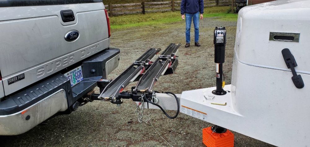

John E Davies Posted January 11, 2021 Share Posted January 11, 2021 (edited) Not to throw any more fuel on your “worry fire”, but you also need to be thinking about how to make your Ram look less tempting to a casual smash and grab thief. That is probably a good subject for a new thread, but basically try not to leave anything unusual or valuable exposed. At the very least, a dark blanket over the top of loose gear is a good start. Heavy window tint is good, but I don’t like that method. Removing the rear seats entirely and installing secure storage lockers is much better but big $. You can go crazy with window anti-theft film and extra door locks ... https://expeditionportal.com/forum/threads/recommended-overland-hardware-lock-hasps.15697/ ... but that is more appropriate for visiting Third World areas. In reality you are most likely to find a stranger hanging around waiting for your return, so he can beg you to let him look inside your cool trailer..... Get used to that. John Davies Spokane WA Edited January 11, 2021 by John E Davies 3 1 "Mouse": 2017 Legacy Elite II NARV (Not An RV) Two Beds, Hull Number 218, See my HOW TO threads: https://olivertraveltrailers.com/topic/john-e-davies-how-to-threads-and-tech-articles-links/ Tow Vehicle: 2013 Land Cruiser 200, 33" LT tires, airbags, Safari snorkel. Link to comment Share on other sites More sharing options...

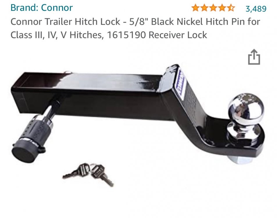

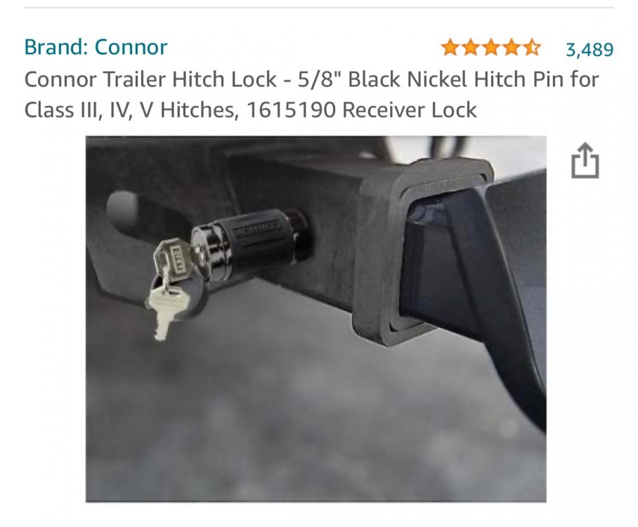

Moonlight Mile Posted January 11, 2021 Author Share Posted January 11, 2021 PS. I looked at the #1 thing’s pics at the Amazon link. I think I see where I am confused. Or was. I don’t have the thing with the ball on it. I DO have the square thing (receiver) as part of the truck. The Amazon pics: Have: square hole thingy. Don’t have: big ball thingy coming out of square hole thingy. 2021 Elite 1 -- Hull #731 Ram 1500 Rebel 4x4 Now Sold Link to comment Share on other sites More sharing options...

Moderators SeaDawg Posted January 11, 2021 Moderators Share Posted January 11, 2021 It will all make a lot more sense when you see the system put together. You can try your hitch lock without the hitch. Run it through the holes in the "square thingy," your truck's "receiver, to make sure it's long enough, and whether it's the right diameter for the hole drilled in your receiver. 2 2008 Ram 1500 4 × 4 2008 Oliver Elite, Hull #12 Florida and Western North Carolina, or wherever the truck goes.... 400 watts solar. Dc compressor fridge. No inverter. 2 x 105 ah agm batteries . Life is good. Link to comment Share on other sites More sharing options...
Moonlight Mile Posted January 11, 2021 Author Share Posted January 11, 2021 Just now, SeaDawg said: It will all make a lot more sense when you see the system put together. You can try your hitch lock without the hitch. Run it through the holes in the "square thingy," your truck's "receiver, to make sure it's long enough, and whether it's the right diameter for the hole drilled in your receiver. I hope so. Rep says I DO need the big YELLOW REESE THING. I have never been so confused in my life. 2021 Elite 1 -- Hull #731 Ram 1500 Rebel 4x4 Now Sold Link to comment Share on other sites More sharing options...

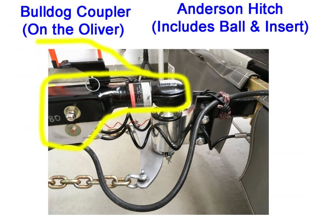

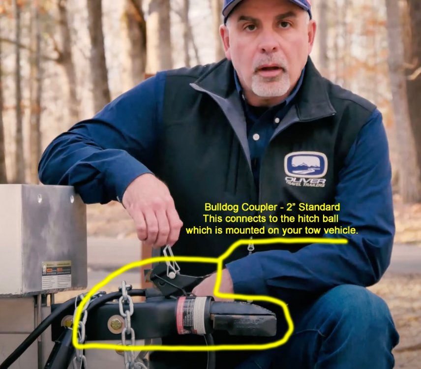

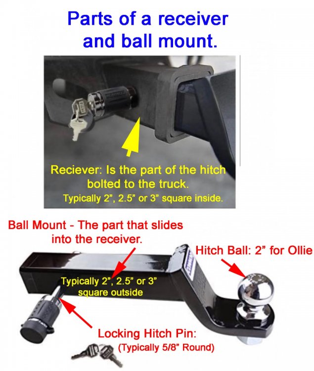

Galway Girl Posted January 11, 2021 Share Posted January 11, 2021 Hitch parts definition based on your pix...you'll be fine and we hope to see you on the road some day. 2 1 2019 Elite II (Hull 505 - Galway Girl - August 7, 2019 Delivery) Tow Vehicle: 2021 F350 King Ranch, FX4, MaxTow Package, 10 Speed, 3.55 Rear Axle Batteries Upgrade: Dual 315GTX Lithionics Lithiums - 630AH Total Inverter/Charger: Xantrex 2000Pro BLOG: https://4-ever-hitched.com Amazon Oliver Outfitters Guide: https://amzn.to/2mAAgPO Link to comment Share on other sites More sharing options...

Moonlight Mile Posted January 11, 2021 Author Share Posted January 11, 2021 Just now, ctshort09 said: Hitch parts definition based on your pix...you'll be fine and we hope to see you on the road some day. Thank you! I am probably about to buy more stuff I don’t need. But this is *very* helpful. I do have a receiver (class IV). I do have a locking hitch pin. I do NOT have the ball mount or the hitch ball. I assume the OTT people provide those parts, are they not part of the “bulldog” and “Anderson” I am getting with the Elite 1? 2021 Elite 1 -- Hull #731 Ram 1500 Rebel 4x4 Now Sold Link to comment Share on other sites More sharing options...

Galway Girl Posted January 11, 2021 Share Posted January 11, 2021 (edited) 2 hours ago, SherMica said: not part of the “bulldog” and “Anderson” I am getting with the Elite 1? The "bulldog coupler" is the connection point bolted on the trailer. The bulldog coupler connects to the Anderson trailer hitch ball which is slid into the "receiver" on the tow vehicle. When you hook up that the "Bulldog Coupler" is lowered down onto the "Anderson Hitch Ball" as shown below: That picture of the hookup is from John Davies...(thanks for the great post John.) Have fun with your new Ollie. CS Edited January 11, 2021 by ctshort09 2 3 2019 Elite II (Hull 505 - Galway Girl - August 7, 2019 Delivery) Tow Vehicle: 2021 F350 King Ranch, FX4, MaxTow Package, 10 Speed, 3.55 Rear Axle Batteries Upgrade: Dual 315GTX Lithionics Lithiums - 630AH Total Inverter/Charger: Xantrex 2000Pro BLOG: https://4-ever-hitched.com Amazon Oliver Outfitters Guide: https://amzn.to/2mAAgPO Link to comment Share on other sites More sharing options...

JRK Posted January 13, 2021 Share Posted January 13, 2021 CT short Thanks for the picture. I knew nothing about the Andersen, other than Oliver sales told me that I needed it. I said okay. I now know what I need, and don't need, when I pick up my Elite I in March. And have a better idea how to secure the trailer and hitch. Thank you very much. SherMica, I had a similar question about what I was going to need - I am getting the Andersen for my Tacoma and Elite I. I now know that I don't need anything, other than the square thing that the thingy slides into - the receiver, the part that is mounted to the truck. Everything else will be provided by Oliver at delivery, it seems. We won't need to have a ball, or the insert - just the brake controller and seven pin plug. I couldn't ask that question the way you did, because I am a 66 year old male who is supposed to know stuff 🙂 I now understand why I was getting confused answers when I asked what insert height I needed to take with me. I don't take one. 1 2 2014 Toyota Tacoma 4x4 2021 Elite I #758 Link to comment Share on other sites More sharing options...
