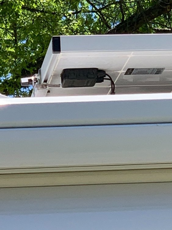

TexasGuy Posted May 29, 2021 Author Share Posted May 29, 2021 There is a connection box on each panel. Anything inside worth checking ? 2021 Legacy Elite II Hull #807 - 2021 F150 w/ 3.5L EB and max tow package Link to comment Share on other sites More sharing options...

SNY SD UP Posted May 29, 2021 Share Posted May 29, 2021 pulled out the ladder and re-examined the connection boxes under the solar panels. Boxes & Cables .et.al seemed to be connected (not loose) securely & properly. i am beginning to think i may have battery issues, rather than solar, as the Solar (charging) Lights lights show that it appear to be working. i forgot to check for current coming in from solar, so i will (as in learn) do that. Maggie & Bryan | Arnegard, ND | 2020 LE II "Twins" Hull #665 | 2021 RAM 2500 6.4L HEMI Gasser 4dr 6.5' bed Link to comment Share on other sites More sharing options...
