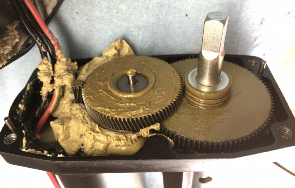

Most likely a drive gear broke, this will help you figure out what is going on. The grease in my tongue jack was like Pla Dough. I haven’t pulled the rear ones apart yet….

I haven't taken the motor head apart but recently had to replace both switches on the front jack due to corrosion.  I looked all over for the parts and Barker by far had the best prices, plus they threw in 3 extra fuses. So I would recommend dealing directly with them for parts. Oddly the person I spoke with said not to take the motor head off for greasing and other maintenance.  Not sure what to make of that. Especially after seeing John's "playdough" grease! Curious to know what gave out. Good luck fixing it!
