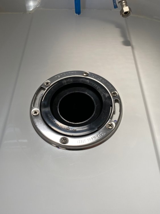

4 hours ago, FrankC said:
...Before I pull the toilet up, for anyone who has taken out the toilet for maintenance, do you have any photos of the seal that is used between the toilet and the black tank?  Just so I have an idea of what to expect it should look like?   Is it a standard toilet flange and wax ring?
Thanks in advance.
Frank, I don't have any pictures but Lee Slusher and I swapped out Hull #050's original plastic toilet with a porcelain throne while out in Quartzsite a few years back.  It was a simple matter of disconnecting the water supply line, removing a couple of bolts and lifting the toilet out. There was no "seal" as in a wax ring, just a smaller pipe exiting the bottom of the toilet and going well into a slightly larger flange on top of the black tank. Also, there was no filth as I expected.
All that said, remember that the gray and black tank vents merge under the vanity and exit out the top of the trailer. If the outside vent exit is somehow blocked, theoretically sewer gases could back up and exit the shower drain. That's close enough to the toilet base to perhaps make the stink source confusing.
