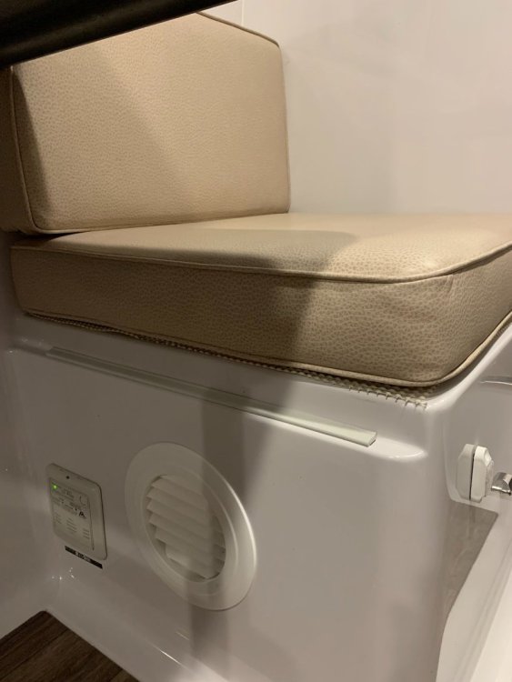

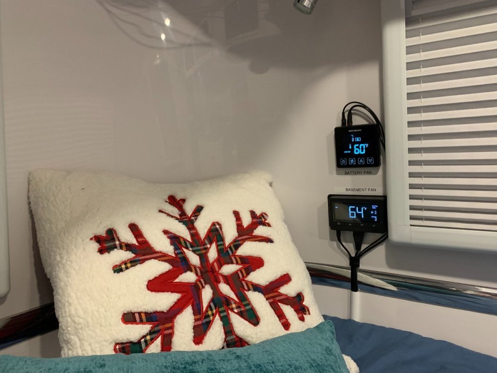

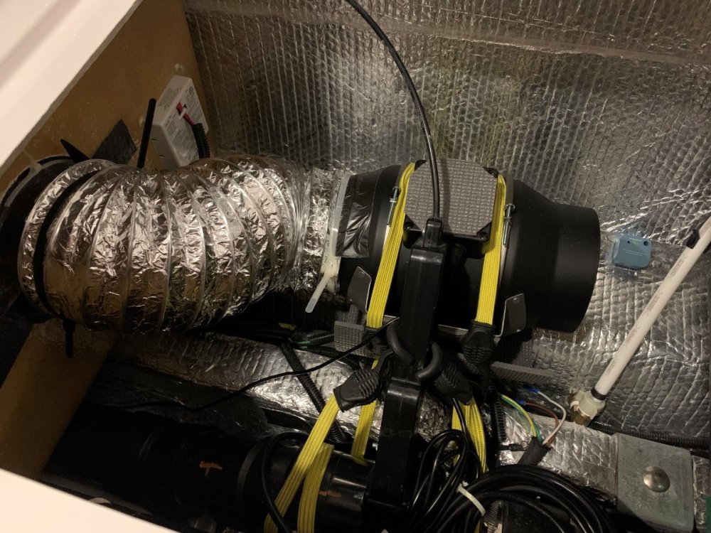

NCeagle Posted December 28, 2021 Share Posted December 28, 2021 18 hours ago, Kirk Peterson said: I agree with MaryBeth, I would love to see photos, if not too much effort NCeagle! If I got brave enough I would love to add some vents. Who knows, might happen. 🙂 Ok, I did post some photos of the battery box design I used in John Davie's original how to post: https://olivertraveltrailers.com/forums/topic/5301-how-to-lithium-battery-powered-vent-system/ I also noticed that I never posted pictures of my bilge / basement solution. It's pretty simple - bungee cord simple. 🙂 The fan only has a duct on the exhaust side so the fan pulls air from right under the seat and exhausts it into the cabin. When everything is closed up and the fan is running, the cabin air is pulled into the basement (primarily) through the existing heat return vent under the curb side bed, so cabin air is circulated throughout the basement pretty well when this fan is running (all the time in my case). Here's the 6" cabin vent under the dinette seat: And here's the smart fan and duct under the seat: I keep thinking I should make a more permanent mount for the fan, but it's held in there with bungees for over 5K miles without budging, so I've got that on the back burner. I also tapped into the back of the 120V receptacle under the seat right next to the fan for the power. I put the controller for this basement/bilge fan in the back of the cabin out of the way next to my battery compartment fan controller: Here's the smart fan and vent I used for this project: AC Infinity CLOUDLINE T6, Quiet 6" Inline Duct Fan with Temperature Humidity Controller - Ventilation Exhaust Fan for Heating Cooling Booster, Grow Te HG POWER 6 Inch Round Air Vent ABS Louver Grille Cover White Soffit Vent with Built-in Fly Screen Mesh for Bathroom Office Kitchen Ventilation 3 1 2020 Elite II, Hull 688 --- 2021 Silverado 2500HD, 6.6L Duramax Diesel Link to comment Share on other sites More sharing options...
snakeriveridaho Posted December 28, 2021 Author Share Posted December 28, 2021 Very nice NCeagle! Thanks fro the additional information and the photos! 1 1 Kirk and Carrie Peterson Twin Falls, Idaho 2018 Ram 3500, with overland conversion: Rooftop tent, water, stove, Battle Born batteries, lockers, onboard air, raised air intake, Warn winch. 2023 Elite 2, twin beds, delivered December 5, 2022 Truma package, lithium platinum package. Hull #1305 Link to comment Share on other sites More sharing options...
