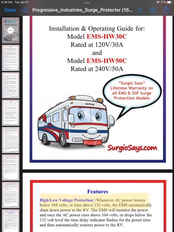

Moderators mossemi Posted January 12, 2022 Moderators Share Posted January 12, 2022 (edited) Probably a hard question to answer, but if the storage facility is supplying 111 to 112 VAC in the middle of the day, which is low in my opinion, what is the supplied power when everyone else is charging? I guess you would have to be there at dusk to find out. The EMS shuts down below 104V or above 132V per the manual, so it’s possible that the supplied power may be too low due to demand. If the facility consist of mini warehouses and other tenets are there is the evening working on the cars, trucks, boats or whatever there may be a higher demand for power at night than in the day. I would mention the low power readings to facility management and maybe talk with other RV owners about their experiences. My Ollie is plugged into a 20 amp circuit at my house via a 50' 12/3 extension cord and I consistently get 119 to 120 volts at the trailer. And if you can verify power at the source that you plug into that may be useful. If the facility power is not a problem then take the batteries to a battery supplier and have them load tested. After confirming good power supplied to the trailer and the batteries fail a load test, be all means jump into that rabbit hole. Mossey Edited January 12, 2022 by mossemi Remove duplicate picture 4 Mike and Krunch Lutz, FL 2017 LEII #193 “the dog house” Link to comment Share on other sites More sharing options...
Moderators SeaDawg Posted January 12, 2022 Moderators Share Posted January 12, 2022 @Liana, as @mossemi said, if you were getting 112 mi-day, and a bunch of other people are charging or using power otherwise, at dusk, your ems, and/or your pd charge wizard will shut down if voltage received is too low, as i mentioned earlier. Do talk to the management. You may not have been charging much, if at all. Have you visited the storage site again, to see what your readings are, after sunset? Frankly, I'd cut off the solar, remove the batteries, take them in to an auto parts shop, and get them load tested. See if it's worth trying to bring them back. If autozone or Napa says it's worth a try, take them home, put them on slow chargers, and see what you get after a few days. Even really dead batteries will display over 13, when charging. But, they'll very quickly drop down to 12.0 or 12.2 when the charger is disconnected, and any small load is applied. I'm sorry this has happened. It may be possible to revive flattened batteries, or it may not. Depends on how long they've been flat, and how many times they've cycled. At least you got 3 or 4 years. Whether you jump down the lithium rabbit hole, or replace with agms, is really up to you. But, I'd really want to find out why the batteries weren't charging, in the first place before I replaced them, and fix that situation first. No point in throwing good money after bad, as my mom would say . 1 4 2008 Ram 1500 4 × 4 2008 Oliver Elite, Hull #12 Florida and Western North Carolina, or wherever the truck goes.... 400 watts solar. Dc compressor fridge. No inverter. 2 x 105 ah agm batteries . Life is good. Link to comment Share on other sites More sharing options...

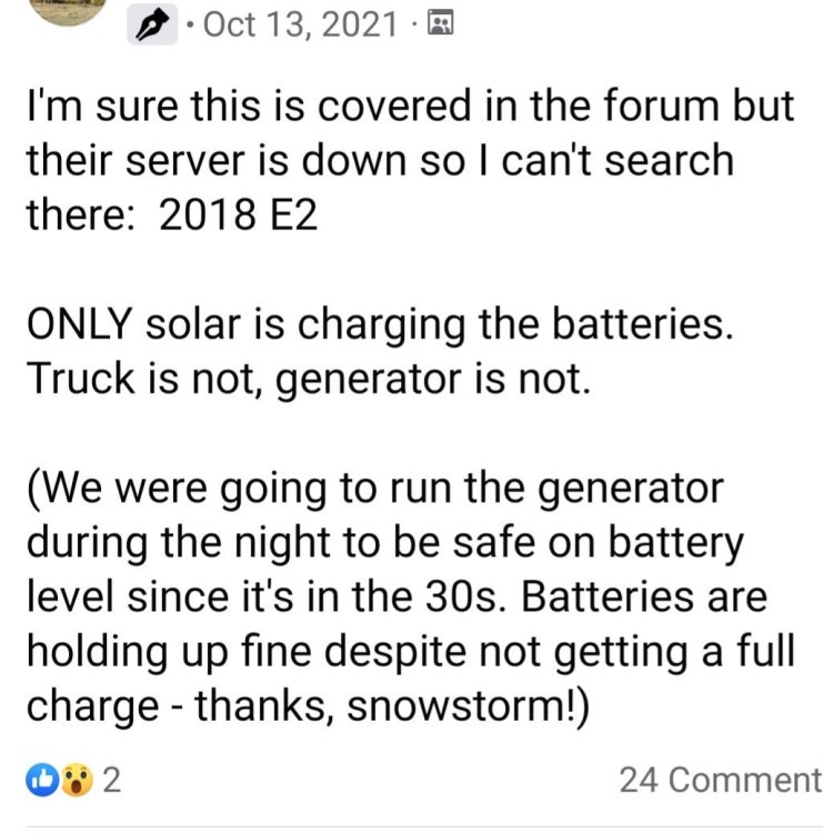

Moderators SeaDawg Posted January 16, 2022 Moderators Share Posted January 16, 2022 @Liana, I saw this on the Facebook page, and wondered if it were you? If so, you've been experiencing some charging issues since October? I omitted the full name, but liana was first name. 2008 Ram 1500 4 × 4 2008 Oliver Elite, Hull #12 Florida and Western North Carolina, or wherever the truck goes.... 400 watts solar. Dc compressor fridge. No inverter. 2 x 105 ah agm batteries . Life is good. Link to comment Share on other sites More sharing options...
Liana Posted January 19, 2022 Author Share Posted January 19, 2022 On 1/15/2022 at 9:14 PM, SeaDawg said: @Liana, I saw this on the Facebook page, and wondered if it were you? If so, you've been experiencing some charging issues since October? Yes, that was me. That issue was related to not having a bonded plug for the generator (we were boon docking in colder weather). However, we started noticing in November that in full sun all day, the batteries were not getting back to full charge, so, yes, this has been going on for a while. Our trailer has been in storage since Thanksgiving and I only went back to check on it when I posted this thread having found the batteries all the way down and low voltage getting into the trailer. I set our timer to have power on from dusk to dawn (shh, don't tell the manager!) and am seeing that indeed, the batteries are still not getting back to full charge. Probably should do as you suggested and pull them to have them load tested. 2018 LE2 #333 "the Otter" 2015 Silverado 2500HD Link to comment Share on other sites More sharing options...
Moderators SeaDawg Posted January 19, 2022 Moderators Share Posted January 19, 2022 I'm sure you have looked, but I'd run through everything again. Make sure you have no heavy unnecessary loads on batteries. Low angle sun in November might not allow you to bring batteries to 100 per cent with just solar, if it was cold, and you were running furnace fan a lot. Batteries will sulfate if charging too little, not reaching full, even agms. That shortens life. Lead acid batteries of any sort like to be charged to full, and not heavily discharged. Your pd charger runs a mild "equalizer" desulfating charge every 23 to 25 hours, if plugged in consistently, which is short, and doesn't harm agm batteries. I don't think that happens when plugged in and getting power for only a few hours. (NOTE: this is not the same as fla equalization on the Blue Sky, which you should NEVER do on agm batteries. This is ONLY for flooded batteries. ) Could be any number of problems. It may indeed be time to take the batteries out and get them load tested, as miserable as that is, due to weights. It's really the only way to know, short if investing in a load tester. Unplug. Turn off the solar, battery disconnect. Take photos, so you know how to hook them up again. Make sure all battery leads are isolated. Good luck. 3 2008 Ram 1500 4 × 4 2008 Oliver Elite, Hull #12 Florida and Western North Carolina, or wherever the truck goes.... 400 watts solar. Dc compressor fridge. No inverter. 2 x 105 ah agm batteries . Life is good. Link to comment Share on other sites More sharing options...

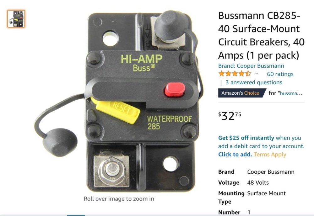

Moderators topgun2 Posted January 23, 2022 Moderators Share Posted January 23, 2022 David - Somewhere in your LE2 you should have a solar disconnect switch similar to THIS ONE. It is most likely located under the street side bed area. Switch it to the "OFF" position and your panels will not be transmitting electricity to the batteries. You should disconnect anything that runs off 12 volt power. This would include your inverter and propane detector. Also turn off the two circuit breakers that are most likely near the solar disconnect switch shown above that look like THIS. Simply press the red button down until the little yellow flag pops out of the side. Note that when it comes time to turn these back on all you have to do is press the yellow flag back into the case. Don't forget to take pictures of the batteries from several different positions (as Sherry mentions above) so that you can reconnect things in the proper manner. Bill 3 2023 Ford F150 Lariat 3.5EB FX4 Max Towing, Max Payload, 2016 Oliver Elite II - Hull #117 "Twist" Link to comment Share on other sites More sharing options...
bhncb Posted January 23, 2022 Share Posted January 23, 2022 16 minutes ago, topgun2 said: Somewhere in your LE2 you should have a solar disconnect switch Not sure when in the production sequence it occurred but my later 2018 with Zamp controller did not have a disconnect of any kind on either side. 2 Link to comment Share on other sites More sharing options...
Moderators mossemi Posted January 23, 2022 Moderators Share Posted January 23, 2022 4 hours ago, bhncb said: Not sure when in the production sequence it occurred but my later 2018 with Zamp controller did not have a disconnect of any kind on either side. I agree! My 2017 was equipped with a automatic resetting circuit breaker on the positive output of the Zamp charge controller and without a manual disconnect before or after the charge controller. I did install a circuit breaker before and after the Victron charge controller when I installed it. If you do not have a method to disconnect the solar charge controller output, I would suggest you purchase a moving blanket and cover the solar panels whenever you are working on the solar system and batteries. Mossey 1 Mike and Krunch Lutz, FL 2017 LEII #193 “the dog house” Link to comment Share on other sites More sharing options...
Minnesota Oli Posted January 23, 2022 Share Posted January 23, 2022 5 hours ago, mossemi said: I agree! My 2017 was equipped with a automatic resetting circuit breaker on the positive output of the Zamp charge controller and without a manual disconnect before or after the charge controller. I did install a circuit breaker before and after the Victron charge controller when I installed it. If you do not have a method to disconnect the solar charge controller output, I would suggest you purchase a moving blanket and cover the solar panels whenever you are working on the solar system and batteries. Mossey Mine is a 2019 and was set up the same as Mossey. I also added a disconnect switch before the charge controller and a circuit breaker after charge controller. Here is a pic of disconnect switch and Victron charge controller monitor. 1 Link to comment Share on other sites More sharing options...
Moderators SeaDawg Posted January 23, 2022 Moderators Share Posted January 23, 2022 The moving blankets would be my advice, too. Dark ones. Then, get a switch installed. I wonder why there isn't one? It's not often that we need it, but its still important to us. 2008 Ram 1500 4 × 4 2008 Oliver Elite, Hull #12 Florida and Western North Carolina, or wherever the truck goes.... 400 watts solar. Dc compressor fridge. No inverter. 2 x 105 ah agm batteries . Life is good. Link to comment Share on other sites More sharing options...
Moderators mossemi Posted January 23, 2022 Moderators Share Posted January 23, 2022 29 minutes ago, SeaDawg said: The moving blankets would be my advice, too. Dark ones. Then, get a switch installed. I wonder why there isn't one? It's not often that we need it, but its still important to us. A tarp would also work to cover the solar panels. And I think the easiest place to put a cutoff switch or circuit breaker before the charge controller would be in the street side overhead cabinet behind the radio and charge controller. Access the rear of the charge controller through the round hatch. Mossey 1 Mike and Krunch Lutz, FL 2017 LEII #193 “the dog house” Link to comment Share on other sites More sharing options...
Hokieman Posted January 23, 2022 Share Posted January 23, 2022 My 2021, #797 had a BlueSeas disconnect installed as standard. Upper cabinet, street side, with access port to get behind it. 2 “Ramble” - 2021 Legacy Elite II #797; 2020 Ford F-250 Link to comment Share on other sites More sharing options...
