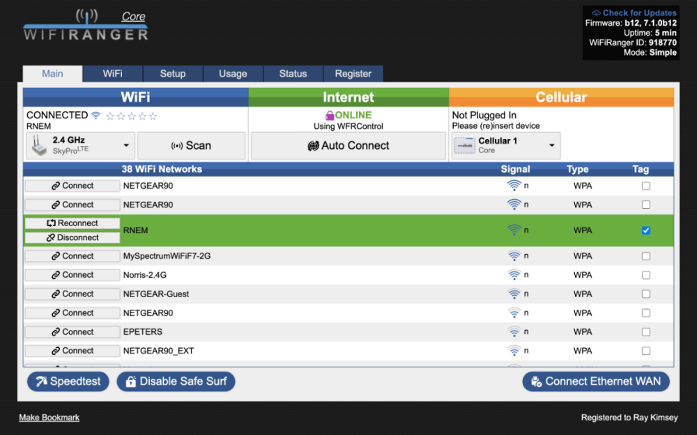

Ray Kimsey Posted July 9, 2022 Share Posted July 9, 2022 Good morning, Yes red light #5 is on. I am actually routing through the WiFi Ranger currently. Included is a picture of what it looks like when working. My WiFi Ranger is on a 2020 model. The password for my model after a reset is changemenowXXXX where the XXXX is the last 4 digits of the WFRID. I would be glad to try to help in any way. 1 2019 Ram 1500 5.7L V8, 3.92 axle ratio - 2020 LEll - Hull #676 Link to comment Share on other sites More sharing options...

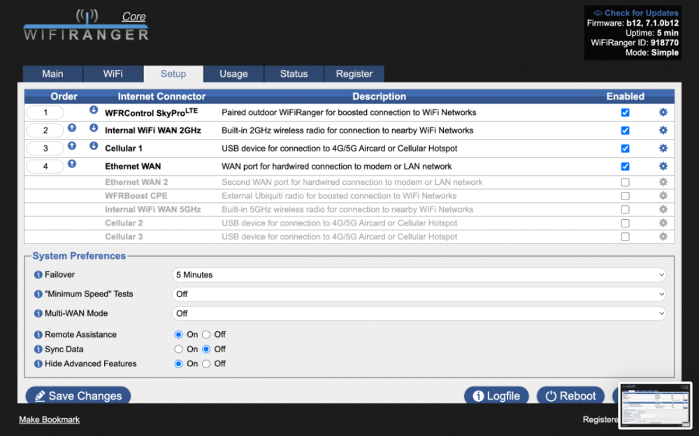

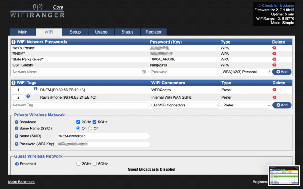

Ray Kimsey Posted July 9, 2022 Share Posted July 9, 2022 My understanding is the SkyPro is the external antenna and that is what I usually use. The Core I believe is an internal antenna. I assume you see a list of networks if you getting a connect button. I have attached some photos of my setup in the control panel. I updated firmware this morning since I was playing with it, so it may look slightly different, but should work the same. In the main tab you see a list of some neighborhood wifi and my house wireless (RNEM). On the WiFi tab I set up the Wifranger as RNEM-ontheroad and entered information on the order of connection priority. First my home wireless and then my phone. Other wifi connections I have made follow those and I remove them every so often. 1 1 2019 Ram 1500 5.7L V8, 3.92 axle ratio - 2020 LEll - Hull #676 Link to comment Share on other sites More sharing options...
dewdev Posted July 9, 2022 Author Share Posted July 9, 2022 Ray: Thanks for posting the Ranger pages. My Ranger is in a 2018 Oliver, so it is a little older (based on the Ranger ID #) but the pages are essentially the same as the ones you posted. I did make one change on the WiFi tab to match what yours had. I then went back to the Maine Tab and hit connect (on the left side) next to my home WiFi name. When I did that the message under the green Internet tab said "Searching". After awhile it change to "Off Line" so it is not picking up my home WiFi even though it is a strong signal. Thinking that the Ranger did not like my WiFi for some reason I changed to a different Network with a "Open" designation from somewhere near me. Same result, with that one as it tried to "Search" and then went to "Off-Line". Kind of frustating, but thanks for your assistance. At least I know I am using the correct procedures. 2 2018 Oliver Elite II, Twin Bed, Hull #354 2018 RAM 1500 Rebel 4 x 4, 5.7 Hemi, 3.92 gear ratio Maine Link to comment Share on other sites More sharing options...
dewdev Posted July 13, 2022 Author Share Posted July 13, 2022 I finally got my WiFi Ranger connected to the internet afer working on it off and on for five days trying all kinds of configurations. Thanks to Ray Kimsey and David (GraniteStaters) for your assistance in the correct way to connect. I was not able to connect to my slow house WiFi internet (provided by my phone company). I also tried to connect to a "Open" web site that the Ranger found and that did not work. For my third try, one of my neighbors let me try their medium speed cable WiFi, but that also did not work. For my 4th try my other neighbor, who had a fast cable WiFi, the WiFi Ranger immediately connected. Now I know that my WiFi Ranger works. The other lesson I learned about the WiFi Ranger company is that they are very slow in returning phone calls. They are very fast if you go to their Support page and open a trouble ticket, which I did as I wanted to update the WiFi Ranger firm wear. I got an answer to my trouble ticket within 2 hours. That is pretty fast in getting a responce. I responded the the tech's e-mail and asked him to call me back as I had some other questions. He called back within a couple of hours and I asked him a bunch of questions including why I could not connect to 3 sites, but I could to the faster one. He could not provide a good answer as he did not know the WiFi configuration and speed of the failed locations. Good lessons learned here on how to communicate with the WiFi Ranger company. 1 2 2018 Oliver Elite II, Twin Bed, Hull #354 2018 RAM 1500 Rebel 4 x 4, 5.7 Hemi, 3.92 gear ratio Maine Link to comment Share on other sites More sharing options...
