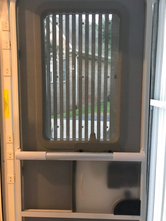

Fritz Posted August 9, 2022 Share Posted August 9, 2022 The Zarcor shade does not slide up-down like the other Oliver shades. The Zarcor shade consists of 2 sheets of flexible plastic with vertical stripes about 1/2” wide alternating with clear material. One sheet is fixed in place on the window, the other slides side to side. When the stripes are aligned (on top of one another), you can see through the clear portions (about half of the window area). When the blind is is in the closed position, the stripes collectively block the view through the window. Quite clever, really. However, I may devise a small removable curtain on the inside of the screen door so that when the window is open it is completely open. 2 2021 Oliver LE2 Ram 2500 diesel Link to comment Share on other sites More sharing options...

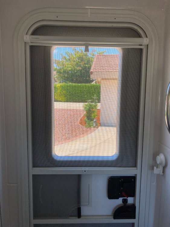

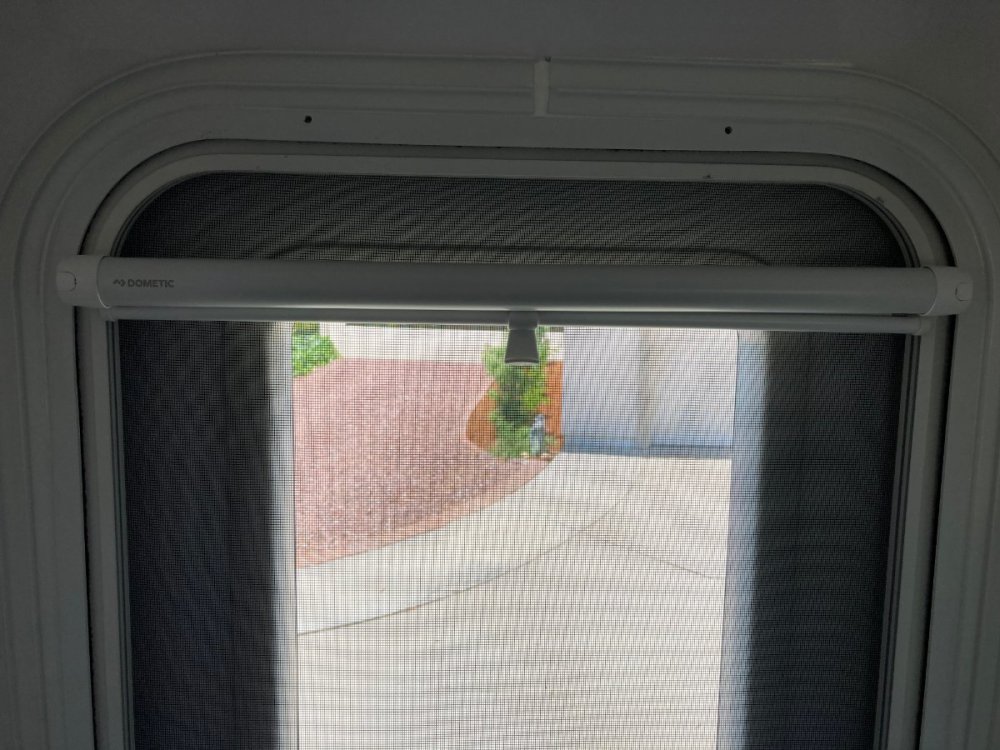

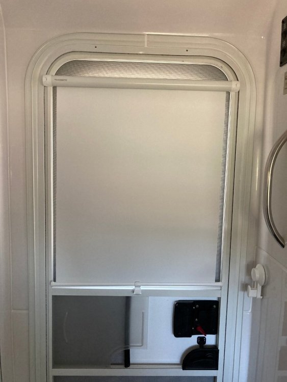

AndrewK Posted August 10, 2022 Share Posted August 10, 2022 Here is another option from Zarcor. It is an OceanAir roller shade, like you would find in an Airstream. We wanted to make sure we had a full, unobstructed view from the window, when the shade was open. It also works as a grab handle, when closing the screen. Here is the part information if anyone is intersted. CSH-3-W - OceanAir CABINshade, White - 21 5/8" x 23 5/8" x 24 1/8. It is a custom size. Andrew 1 7 Andrew, Carianne and Buffy | San Diego, CA 2019 Legacy Elite II Hull #468 "California Burrito" | 2018 BMW x5 35d Link to comment Share on other sites More sharing options...
Moderators mossemi Posted August 10, 2022 Moderators Share Posted August 10, 2022 @AndrewK, and it still looks great! Mossey 4 1 Mike and Krunch Lutz, FL 2017 LEII #193 “the dog house” Link to comment Share on other sites More sharing options...
