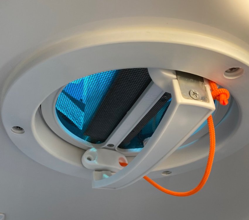

Frank C Posted August 23, 2022 Author Share Posted August 23, 2022 4 minutes ago, John Dehne said: I use a piece of 3/4 white PVC about 8” long. Works great Looks like Oliver has changed suppliers for your model year Elite II bathroom fan. Is the black button on the left of the handle the fan on/off switch or is it supposed to be a latch to hold the cover in the down position? 2 2019 Oliver Legacy Elite II - Hull #461 Tow Vehicle: 2019 Ford F-250 SuperCab 4x4, 6.2L Flex-Fuel engine Link to comment Share on other sites More sharing options...
