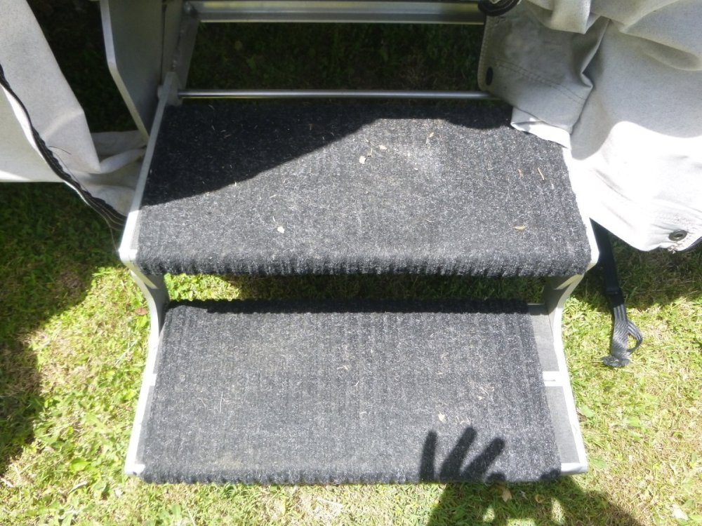

Corvus Posted September 7, 2022 Share Posted September 7, 2022 Apologies for the click bait title, but we really do have Grubby Feet and like them a lot. The recent thread Stabilize Oliver II suggestions reminded me of how well our Grubby Feet have worked and thought I would pass it on. Initially our Oliver was in a storage lot infected with Nostoc, a cyanobacteria. When dry it was crisp and dead looking but add a little moisture and it becomes a slippery slimy mess that spreads everywhere it is tracked. It even created a mat of slime on the bare steps making them slippery. I tried one of the carpet wraps on the steps, but it just became a slippery and slimy mess. I came across Grubby Feet while searching for something that would give us more confidence when using the steps. After installing ours nearly two years ago I can say they have performed and lasted better than expected. Here in the southeast it has rained a lot the past two years and I've worn many types of shoes and can say I feel confident when using the steps now. The mats have worn well, looking and feeling nearly the same as they did when I installed them. The only sign of aging is a slight wear pattern and a couple strands that separated on the edge. 4 Jerry & Kathy 2019 LEII Standard #539 + 2019 Tundra Limited 4X4 Link to comment Share on other sites More sharing options...

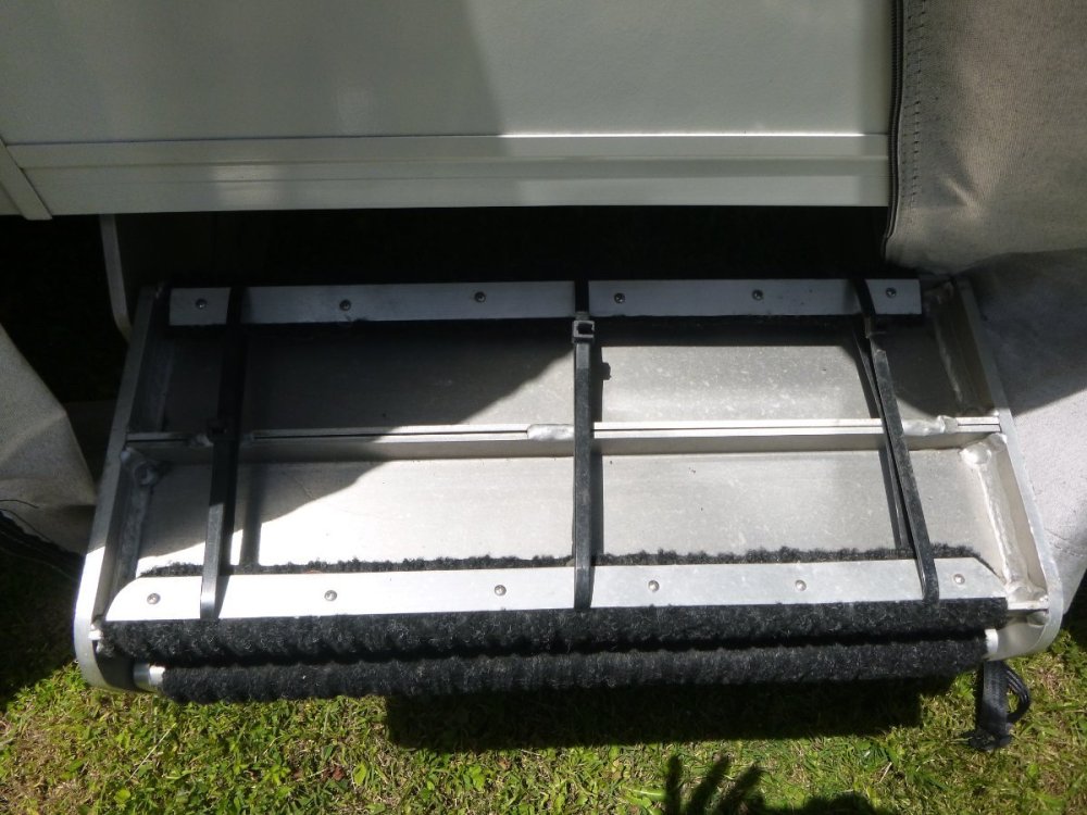

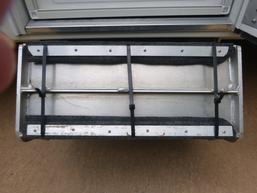

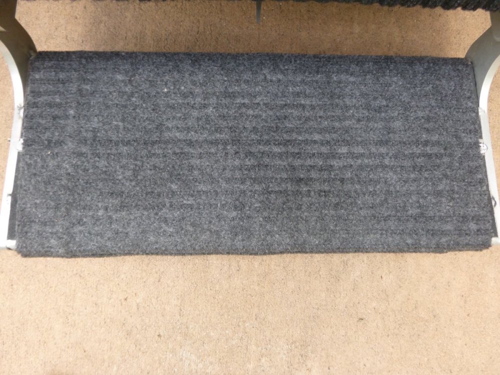

Moderators topgun2 Posted September 7, 2022 Moderators Share Posted September 7, 2022 Even though I'm not sure how my stair covers would do with slimly bacteria, they are made from Dollar Store (really $1.25 Store) mats. It takes two mats cut to size, 6 zip ties, some 1 inch aluminum flat stock and 24 stainless bolts. My first set of these lasted 5 years. Bill 4 2023 Ford F150 Lariat 3.5EB FX4 Max Towing, Max Payload, 2016 Oliver Elite II - Hull #117 "Twist" Link to comment Share on other sites More sharing options...
