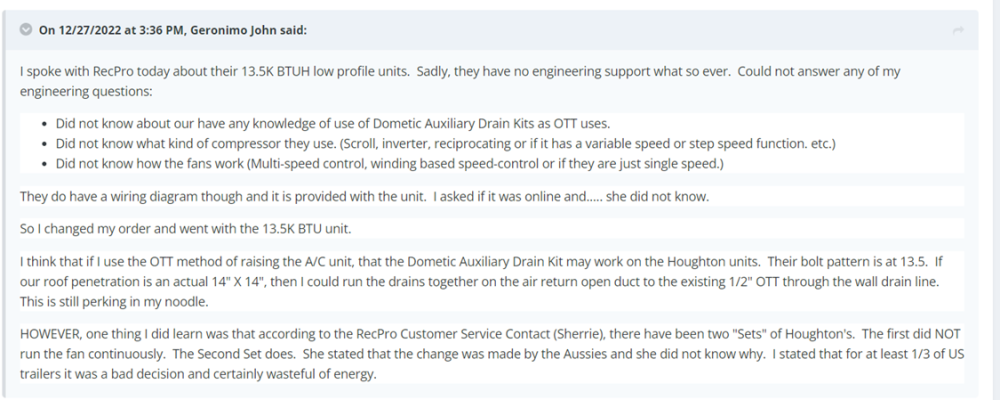

Geronimo John Posted January 18 Share Posted January 18 I call your attention to the last paragraph of my late December post: So it appears we all pretty much agree that the problem is humidity evaporating off the coil due to the fan running continuously. The cause is a design change by Houghton, likely to benefit Aussie owners who have far less of a humidity issue than we do in the USA. Since the question can not be answered by RecPro, time to bypass them and ask Houghton directly what specifically needs to be done to switch our Type 2 units to Type 1? I'm focused on the condensate issue. Someone want to tackle this issue directly? GJ Tug: 2019 F-150 SuperCrew Lariat, 3.5L EcoBoost, Max Trailer Tow, FX-4, 4X4, Rear Locker Link to comment Share on other sites More sharing options...

bhncb Posted January 23 Share Posted January 23 On 1/19/2023 at 1:46 PM, bhncb said: OK you wore me down. Sent Houghton an email asking about the evap fan control and option for internal condensation. We'll see how responsive their are. The General Manager of Houghton responded to my questions with the following: Thanks for reaching out with your queries. To answer your questions regarding the Houghton A3400 and A2801: 1 – There is no option or modification available to collect condensate and direct it to an internal drain. 2 - There is no option for stopping the inside fan when the compressor has stopped in Cooling mode. We do this very deliberately to maintain air flow over the return air temperature sensor. This ensures that the unit will respond appropriately to the cabin temperature. If the fan is stopped then the unit is no longer sensing the true air temperature of the living space and may not turn on again until the space is unacceptably hot. We have used this arrangement in the Australian climate for many years. Our northern states are hot and tropical, similar to Florida, and our units have excellent performance in these conditions. However, we are aware that this arrangement is not typically what you encounter in the USA market. I am very interested in better understanding your concerns about the inside fan remaining on once the compressor has stopped. Can you help me to understand the source of your discomfort? 1 Link to comment Share on other sites More sharing options...
