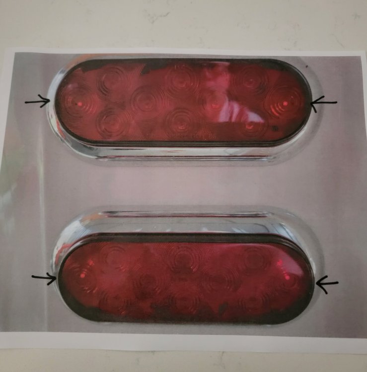

Collier and Joan Posted October 30, 2022 Share Posted October 30, 2022 As soon as I disconnect from tow vehicle, these 4 lights come on dimly lit on both sides of trailer. 2019 Oliver Legacy Elite II - Delivery Date Aug 29, 2019 Ford F150 XL Supercab - 3.5 EcoBoost Link to comment Share on other sites More sharing options...
Minnesota Oli Posted October 30, 2022 Share Posted October 30, 2022 That would be water in the plug. When wet inside power from wire that leads to battery shorts to wire going to the lights. Link to comment Share on other sites More sharing options...
Mainiac Posted October 30, 2022 Share Posted October 30, 2022 Hold the plug upside down and shake. Get used to storing it upside down too. A dielectric spray would not hurt. Long term could cause corrosion and hence a poor connection. ( I use WD40). We have found that the plug will fit between the frame and the plastic counts cover. We used to hang it over the tounge in the winter too. Until one year soft fluffy snow built up and the wind caused my tailights to come on. it was a head scratcher at first, but the solution was easy... Link to comment Share on other sites More sharing options...
