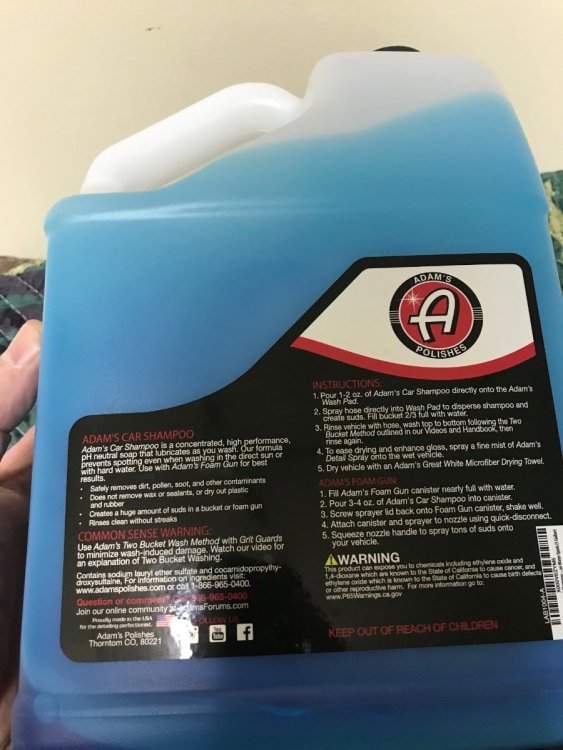

Patriot Posted December 19, 2022 Share Posted December 19, 2022 Here is the PH neutral soap I use when washing CC TV. This was highly recommended by the tech that did the Ceramic coating. I feel sure any PH neutral soap would be fine. I have been traveling and did not have the photos of this soap available. Here is what I use. -Patriot 🇺🇸 1 1 2020 OLEII - Hull #634 TV -2021 F 350 6.7 liter Diesel Lariat Ultimate Tremor aka “The Beast” Link to comment Share on other sites More sharing options...

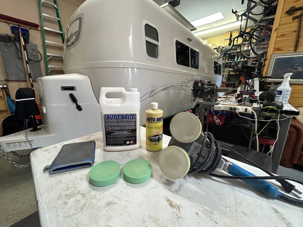

Trainman Posted December 21, 2022 Share Posted December 21, 2022 Everything oxidizes when left outside and in the sun, so not doing anything will defiantly speed up the oxidation process. On ours I buffed in once a year with a good marine fiberglass compound and our trailer after four years looks just like new, yes it does require getting up on some scuffling (ladder not recommended) with a buffer and buffing it, not a fun job. Like I have said many times, being a retired body shop manger for some 30 plus years there is no miracle product that will stop oxidation, but removing it is possible and that's buff it off. The ceramic coatings my be the best way to go for some, but for myself, it's just a coverup and in time your will still have to have it buffed to get down to the original gel coat finish to get the original luster of the trailer back to where it all started. I realize this process may not be able to be done by many, so I would do what works for you, a nice metal building would also work, plus it does bring value to your property. trainman 4 2019 RAM 1500, 5.7 Hemi, 4X4, Crew Cab, 5'7" bed, Towing Package, 3.92 Gears. Link to comment Share on other sites More sharing options...
