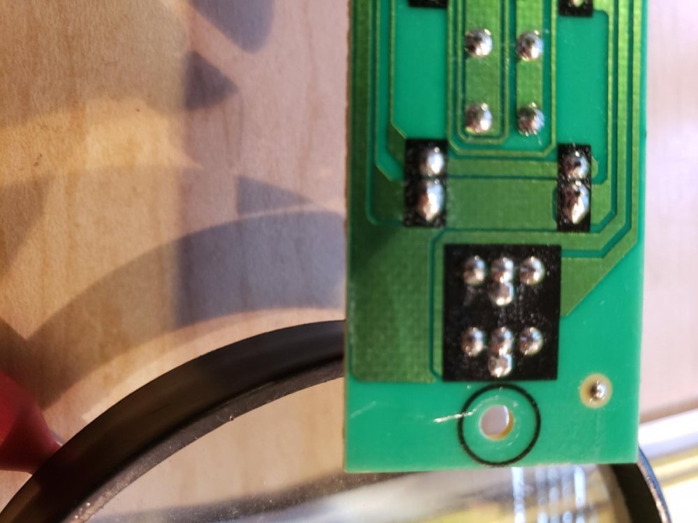

  12. Here is the back of the eyebrow board, rotated 90 degrees, focusing on the power switch. The rows you see L to R are actually vertically disposed. I am getting no continuity from any terminal on the left (top) to any terminal on the right (bottom) when the switch is on, yet the board will still work when plugged back in and the power switch held firmly. I am assuming that the two center solder connections (double lumps) should show continuity when on. Next step? Contact cleaner and compressed air.

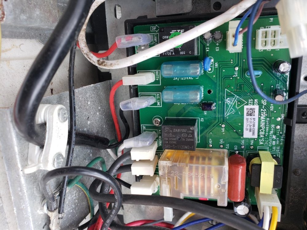

  13. Update: Power into the ignitor (outside) board is OK, all fuses there (3 of them) OK. Appears to be the on/off switch itself. Must be pushed in for a while, firmly, to hear a relay click outside, then inside board lights up. Will not stay "ON" reliably though. Next step: Pull inside board and clean contacts, re test. This image might be rotated, the black AC power cord is at bottom.
