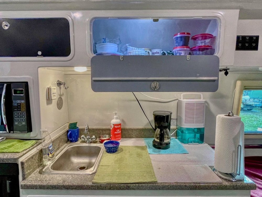

A couple of months ago I posted about wanting to flip the cabinet door above where the coffee pot is. It's finally done (almost). Every step was a two person job. Three wonderful people helped me. I dragged my feet a bit because, honestly, I loved having it open. But it was a pain when moving. Scrapped the old calking and glue off with plastic blades. Cleaned off lingering stuff with acetone. Removed the door from the frame. Flipped the frame upside down and glued it back on using 3M 4000 adhesive. Note, the frame is flexible and wanted to sag, getting it right was tough. The door fits tighter than I'd like but it closes. Screwed the door back on. What a pain. Tiny little screws that aren't magnetic and there is nothing to brace the door on while trying to get the screws started. Because of the curve of the ceiling, the hook had to be placed out aways. Right now it's just being kept open with a couple of bent paperclips until I figure out what's best to use. Here's the finished product:

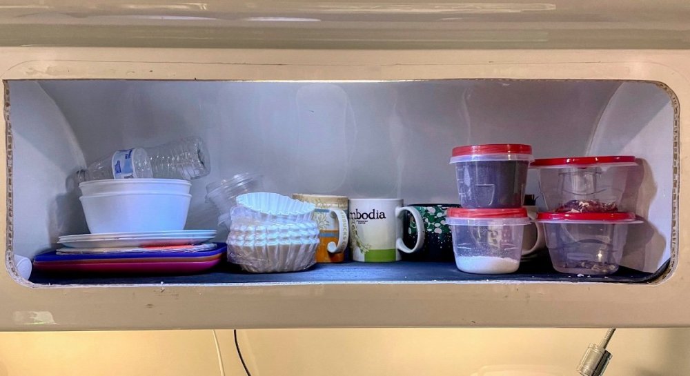

I had to get out the tape measure for this one. The height of the top of the door is 5'10", plenty of clearance for me (5'7 ½") but a problem for taller folks. I thought the ceiling would stop it from going much higher but when we held the door up, it had plenty of clearance. Looks like it's back to the drawing board. In the photo, my index finger is pointing to where a hook would go on the ceiling.

My coffee pot is just under the cupboard and my coffee supplies (coffee, sweetener, cups, filters) are in the cupboard, so the door is right in my face when I'm making coffee. (Yes, I'm serious about my coffee). In the trailer I had before the Oliver all of the cupboard doors opened upwards and I loved it. It's the only trailer I've had that I never hit my head on.

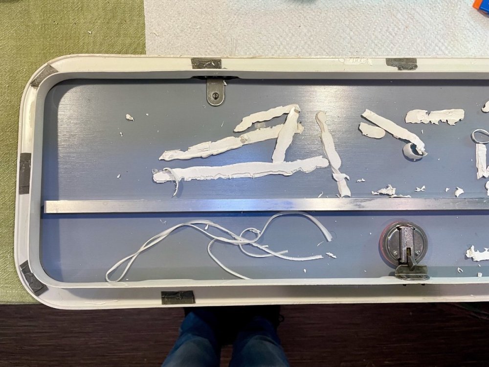

There is residue on the trailer and on the door. There are 6 little strips of thick double faced tape. I'm going to leave them on as a guide for how thick the new adhesive needs to be and will put a little strip of double face tape on them to help with the stickiness. I'll give the hair drier a try and mineral spirits too. Thanks.

The Ceiling is curved where a latch might be most conveniently put. The picture is what I think I will do. At least right away. The hook is at the closest flat point on the ceiling. I'll just put a small decorative chain on the door handle and continue to look at hinge options.

I asked a while back about flipping the cupboard door above stove. With the help of a friend we took the door off. Because of the age of my trailer, other doors may not be mounted the same way. But here's what mine looks like. The thin strands are the clear calking around the door. The thicker ones appear to be a thick adhesive. The fellow who helped me does not believe it is butyl tape. The door has some pieces of double faced tape on it also. I'm guessing they tried to mount it with the double face tape and it wasn't enough so the added the adhesive. The picture of the opening showes the interesting square corner. Sweet Olivia 2014 Hull #53 Twin bed LEII
