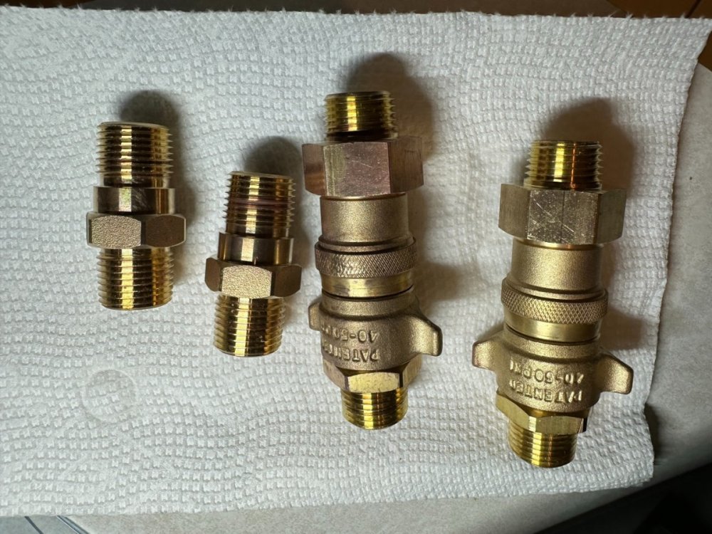

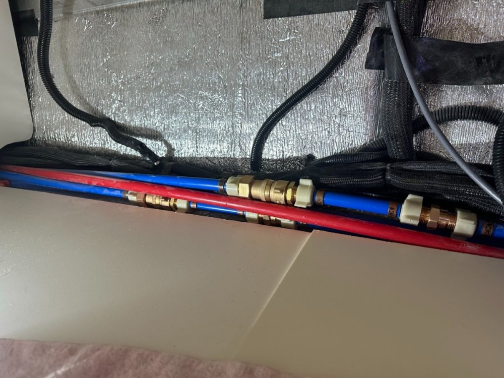

  1. So I think I have fixed 99.9% of my issues. After cleaning the flow restrictors/pressure regulators that helped a lot but I decided to replace them with a hollow pipe (got it at Home Depot, I'm sure there were other ways to do this but this was simplest for me) so there is no restriction. I purchased an external pressure regulator and have that set to 55psi and will use that going forward. I also replaced the faucet head in the bathroom and I have great flow/pressure almost everywhere now. The one place I think the flow/pressure could be better still is the toile. I did try cleaning the filter/screen as was suggested in an earlier post, but I couldn't figure out how to get the filter/screen out so I poured vinegar down the tube and let it sit for a few hours but it didn't seem to help. It's good enough though. The bowl doesn't hold water for very long so have to look into that. The last thing I found which I am sure contributed to a lot of my problems was the anode rod was way overdue to be replaced and water heater was full of scale/buildup. I flushed out the hot water heater, which took a while for stuff to stop coming out and the water to be clear then put in the new anode rod and tested the system and everything is working like new again. So what I have learned from all of this is it's very important to use a water softener and/or flush the lines regularly to avoid buildup. As I said earlier, I do think the cleaning the flow restrictors/pressure regulators made the most difference, when on city water, but I think its best to just replace them. That's probably why they don't have them in the 2018 and newer units. Be sure to use an adjustable external regulator just to be sure. When using the internal water pump cleaning/replacing the screens on the faucets or the faucet head itself made the difference. I did start with the faucets before moving onto anything else and that's what you need to do when diagnosing this kind of problem and remember to confirm you have the same problem on city water and you do with the water pump. I hope this helps someone who finds themselves in a similar situation.
  2. @jd1923 & @Townesw I think i will remove the two pressure regulators from inside the camper (since OTT did in 2018) in favor of using an adjustable one on the hose going to the camper. I think that will be the best solution because I think a large part of my problem came from those getting clogged up. I'll try and replace them this weekend and test it, along with cleaning the filter/screen on the bottom of the toilet as @MAX Burner suggested.
  3. @TowneswI am assuming you replaced the internal pressure regulator with a regular tubing/plumbing?

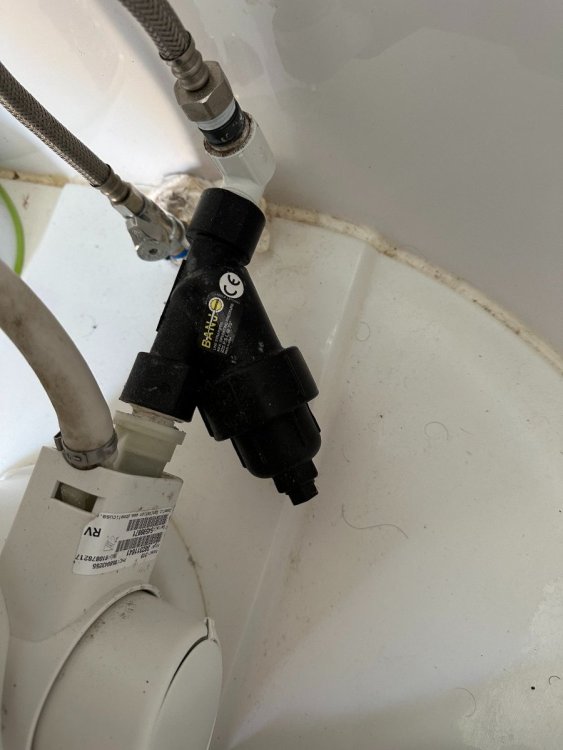

  4. @MAX BurnerThank you for the picture, I did not know there was a screen there. Mine has a filter connected to that but I bet there is still a filter there I need to clean. I have done the filter/aerators in the faucets and so far I think what has made the biggest difference is cleaning the pressure regulators followed by replacing the aerator and or shower head.
  5. @MAX Burner What did you do to increase the flow/pressure to the toilet? I'm not sure what you mean by the diffuser screens?

  9. @jd1923 Thanks for the info. I didn't realize the regulators had the PSI on them, duh. I thought about replacing them but didn't know where to get them and they don't show a brand name to be able to look them up but if/when I replace them I will go with the higher PSI as you suggest. I will still use an external regulator also though. I didn't get a chance yet to do the timed test yet but I will get to it hopefully tomorrow. I was wondering if the length of the plumbing run to the bathroom is what is causing the pressure/flow to be low and the pump surge but I guess I won't know until I get this all fixed but technically the length of the run should effect it unless there are other issues. I don't think I am going to try and replace the fitting to get them to be true 1/2" just yet but might as a last resort. I am planning on doing the vanity mod as well since I already took it out. I'm going to drill into the ends of the clear bars about 1/2" deep and add LEDs (because everything is better with LEDs) and put a power switch in next to the water pump switch just to add some lighting for at night.
  10. @mossemi I did figure out the thing on the toilet was a filter and cleaned it out, there was a lot of sediment in it but it was not clogged. I was going off this plumbing diagram which seemed to match the way my water lines go but I don't have an accumulator and this one does and the the one you posted doesn't so I will take another look at how my liens are run. The one you posted and this one however don't show the inline pressure regulators and backflow valves which I really think they should. I run bathroom sink faucet hose running without the head on in it and seems like a good flow but you can still see it's not steady and the you can hear the pump surging. Still don't know if that is normal. I will give your suggestion a try to try and get a baseline.
