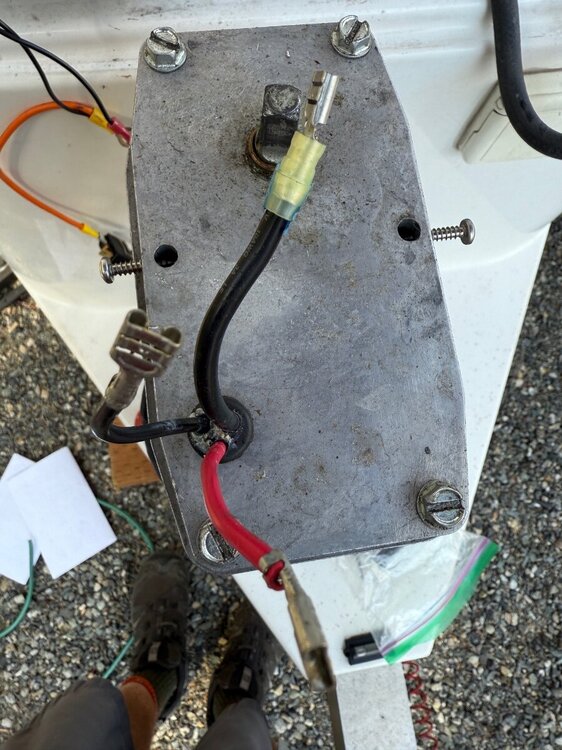

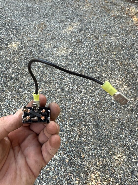

  2. Thanks Mossemi. I appreciate the response. I did see this and there were a couple inconsistencies between the drawing and my "as built". For example I have 3 wires coming out of motor (4th and last photo), not 2 as shown on drawing. Also, there is a double terminal on the toggle that controls the jack with connection for 2 wires one of which is shown on second pic. This is not indicated on drawing. This will teach me to take plenty of pics before removing stuff. Lesson learned....again. I think what would be most useful is if someone could send a couple pics of their jack showing the terminals and which wires go where. Thanks again.

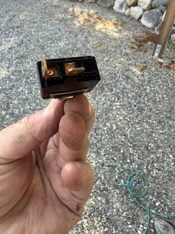

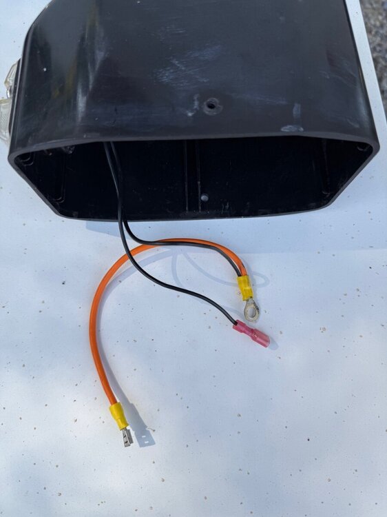

  3. I serviced my VIP 3000 power jack a couple days ago. I have Hull 329 (2018) and I think Oliver has used these jacks for quite awhile (and continues to use them, I believe). In my exuberance (I've done this before) I disconnected the light and up/down switches and re-greassed the gears but did not take any photos to help with reassembly. Now I'm scratching my head trying to figure out what goes where. Can anyone help? The last pic shows the top of the jack motor...it has 3 wires (2 black and 1 red with one of the black wires being thicker at 10GA while the other black wire and the red wire are both 12 GA). The second to last pic shows the motor head cover and wires for the light. I do know that the orange wire is grounded on the top of the motor head. The second pic shows the switch for the jacks up/down control and the first pic shows the switch for the light. The manufacturers wiring diagram is of little help (for me). Maybe a pic or 2 showing what goes where on your rig? I know this is kinda specialized and a big ask. I would appreciate the help. Thanks.
