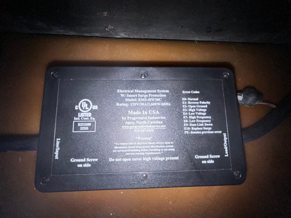

  2. So the saga continues…lost power again and this time it did not come back on. I called Progressive and we opened the box to check the connectors and the relay contact box was completely loose from the case. The mounting screw was there but the nut obviously was bouncing around the case. Ugh. So maybe that was the issue or a contributing one. Need to find that nut and get those Wago connectors to bypass the EMS until I get the replacement. I have the external surge protector ready to go. I guess this is something else to check after bouncing down the highway. IMG_2218.MOV

  6. I’m showing that the shore power goes into the EMS directly. So I looked at the schematic and saw a power indicator. So I decided to plug the Oliver back into show power and everything is back on. What the heck! I’m so very thankful it’s back on camping in Gulf Shores humidity but still confused why it failed. Reading E0, 124V, 18A. Possible surge that tripped something that automatically reset?
  7. No worries. I appreciate the help but I just may need to get this replaced if it is this switch itself. It was making a small intermittent buzzing sound and I was told that was normal by Progressive. I guess it finally went. I believe this is the unit you are talking about?
