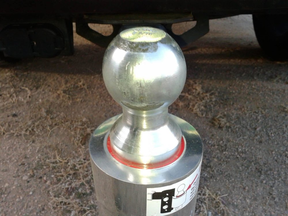

Bulldog coupler destroys Anderson ball
Sage-AndersenHitches replied to John E Davies's topic in Towing an Oliver
Well it is great to see that John is hooking his Andersen WD up properly. Unfortunately the wear on the ball is normal when our hitch is used as designed. With the chains correctly tensioned the coupler does push on the back of the ball and will leave evidence of that. With our WD hitch and a regular coupler the locking claw leaves a (smiley face) in the chrome plating because the ball is designed to be softer than the claw so the trailer is not having excessive wear in inconspicuous safety related spots. It seams to wear rapidly at first then it stops once the initial wear has settled in. Anytime there is metal on metal friction there will be wear, even with grease. As we can see from John's original ball, the difference is where it happens. Is it on the top and front of the ball with a traditional hitch or is it on the backside with the Andersen? If the ball is harder than the coupler the ball will not show much sign of wear but the inside of the trailer coupler will, however; that often goes unnoticed until it is to late. With the design of the Bulldog coupler there is a different wear pattern on the ball and it should wear to a point similar to the photo John provided then neutralize. This should not affect the performance or the safety of the connection at all. -
