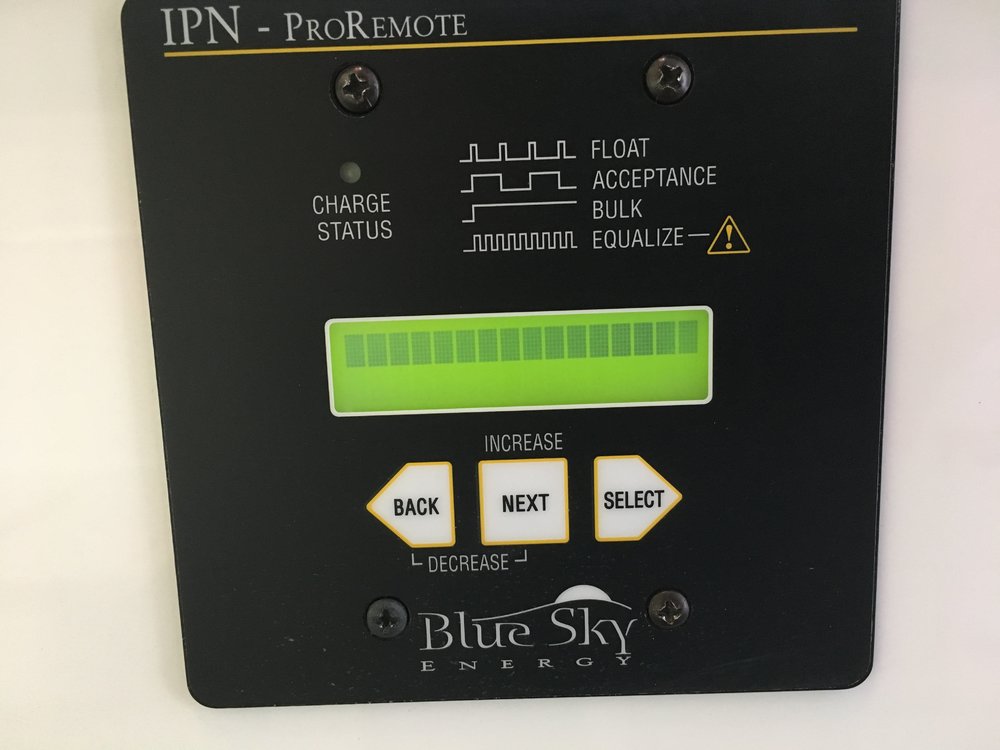

Had an issue with the IPN Remote display not showing any data - See picture #1.

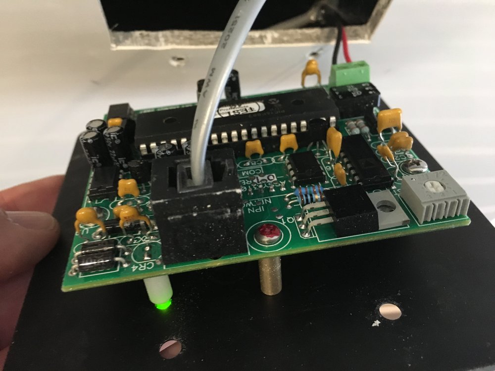

Was advised by Ryan at Blue Sky to unplug the data line at the back of the remote for a few seconds - See picture #2.
Problem solved with a screwdriver and a phone call.  My kind of problem. :-)   Posting here in case anyone has the same issue.  Easy fix.
