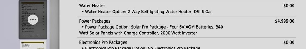

Haven’t checked batteries voltage yet, but here’s the battery type etc. I wonder how long these type of batteries can last?? Charlie
