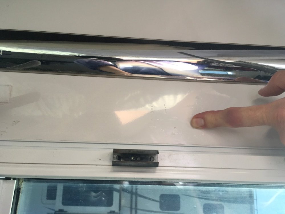

Hi there, My window is leaking quite a bit of water out of the bottom , under the metal strip. This happens every morning after a cold night, when the sun hits the window in the morning. Three of my windows have leaked when it rains, and I cleaned all the weep holes and tracks, but it has not rained since I cleaned the tracks, so I don’t know if rain is still an issue. This is specifically an issue with some type of condensation or humidity coming in from the outside after a cold night, when the sun comes up and warms the window. I am in a micro climate (high desert in CO) in which winter nights can be well below freezing (single digits or less at times), while days can be quite warm, and temps can rise into the 40s. The location is an arid high valley surrounded by very high mountains on all sides, so the mountains create a protective barrier. All of this creates a big difference between cold nights and warmer days. Every morning, my bed gets wet, not good when you have mold sensitivities. So this is specifically an issue with some type of condensation or humidity coming in from the outside after a cold night, when the sun comes up and warms the window, see pic. I tried cracking the window during the night, but this does not solve the problem. The Oliver windows are tricky, so I don’t know how to prevent the leak, because I have been told not to apply sealant (??) though my inclination would be to caulk the inside edge (?) What else can I do? Brief rant alert: I spent a big chunk of my savings when I bought this Oliver, but she has been a 🍋. 😭😭😭 The windows have leaked, there has been a leak between the hulls whenever I use fresh water, with water coming out of the clam shell openings in the bottom, and I have had a significant gas leak, and cannot use the furnace or stove at present. There is a problem with the electrical circuit, where fuses are blowing, and my newly replaced battery never shows an adequate charge. Now, the bathroom fan no longer works, and I am having issues with condensation when the fiberglass gets cold (in addition to window leaking). My Oliver isn’t that old, but I feel like I’m living in a leaky boat, unable to use many of the features. The RV techs have not found the source of the fresh water leak, and many of the techs here are busy, and keep bailing on me (combination weird pandemic after effects, and some wonky people in Colorado who tend to take advantage of “tourists.”). Rant over, let’s start with the windows? If any of you live in CO, do you know of any good mobile techs? I am in Buena Vista, CO. Sorry, I think photos uploaded upside down. Thanks, Margaret

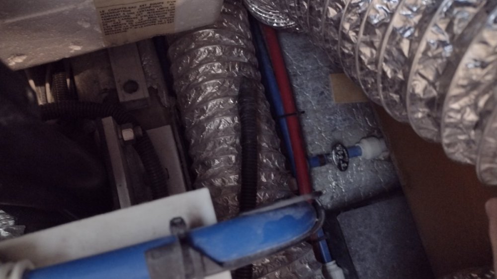

Thanks Mike! I had already tried turning on the pump and opening all the faucets to get the air out. I checked the connections around the pump, as well as checking the filter Is it possible there is a leak in the fresh water tank itself? Now that the windows have leaked too, I feel like I'm in a leaky boat out at sea (and this is monsoon season in CO, AZ, and NM. Thank you

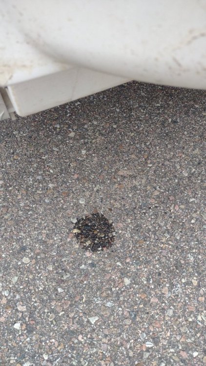

Hi there, When I turn on my water pump (when not on a full hook up), the water pressure is bad, and the faucets sputter like there is air in the line. In addition, there is water coming out of the weep hole in the bottom. Usually there is more than what is shown in pics. I just turned on the faucet so I could show you the issue . So usually, I end up with a fairly large wet spot on the pavement. Last night, there was also water under the fridge. Does this necessarily mean I have a leak (I researched old posts)?? I really hope not, bc I have significant mold sensitivity. I can hear the pump running when I turn it on, do I don't think the issue is with the pump itself Thank you!
