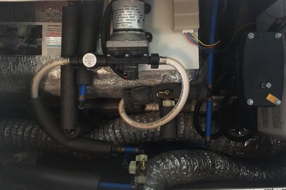

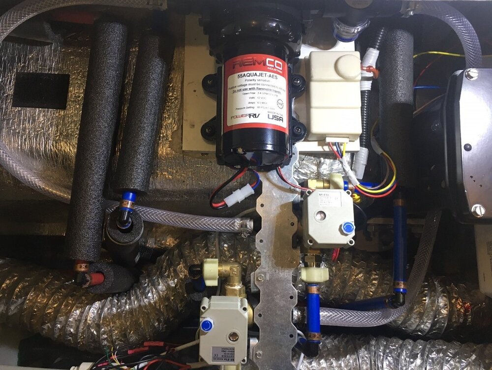

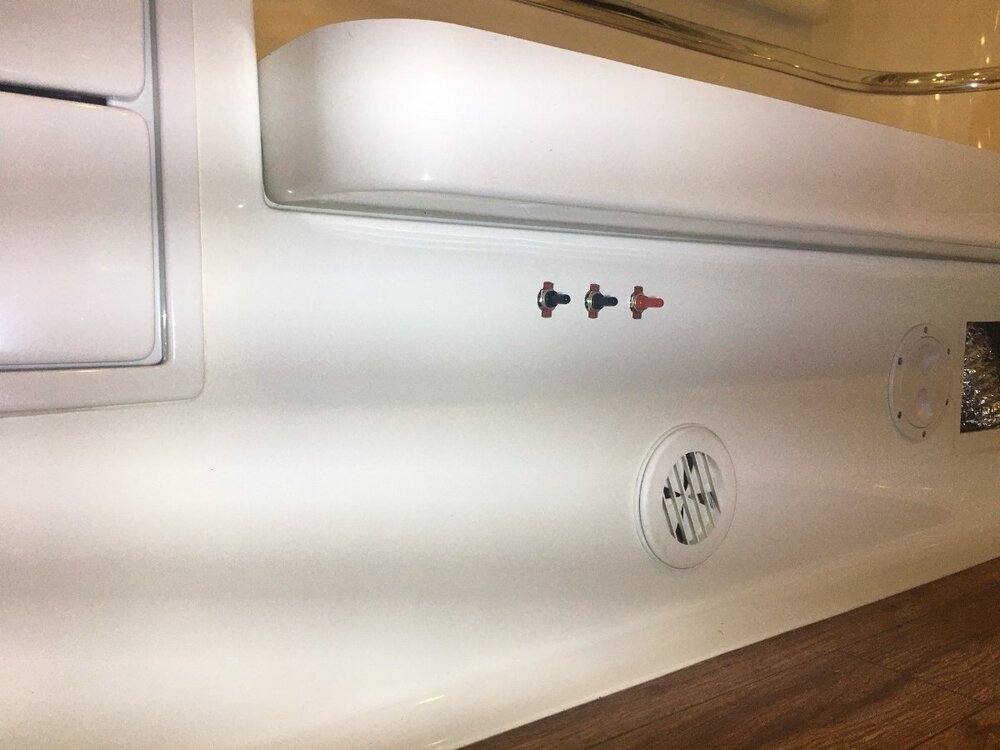

This happens to too many Oliver owners. Many can benefit from upgrading your water pump and valves. I replaced the $50 Made in Mexico Shurflo, spending $200+ on a Made in USA Remco variable speed pump. Also changed the manual valves that had 1/4" ID openings with electric ball valves with 12mm (.47") ID.
I have the pump running when I change the valves (they're wired on the same circuit), no issues. We use the water at night with the pump off, no issues. We have the OTT OEM defective Fresh Tank suction hose. that was installed on some old hulls, where it runs out of fresh water after 18 gallons. We run out of water often, filling from the boondocking port, no issues. The high-quality variable speed pump always primes itself, no air locks ever. See before and after pics.
 Nice! It got jammed up pretty quickly!
Quote
Thanks for the ideas and the pics 🙂
