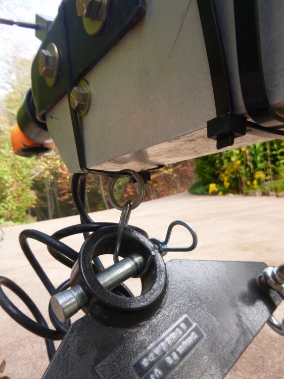

When the Andersen WDH is disconnected from the two vehicle the "whale tail" is usually just left laying on the ground.  This allows it to get sand, mud, etc. to get all over it and can make it more difficult to re-attach it when it comes time to move.  A zip tie, a ring and a large hook help solve that problem.
