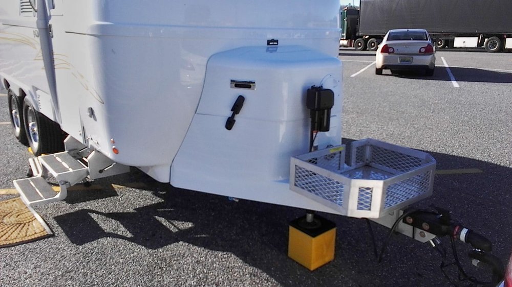

That looks like a good system, I've been watching the threads you guys have started on these so far and I do feel the need for it. But right now, we're still on the road and I have the Hopkins level on the Olli that I can always see thru the mirror. It's not a replacement for a good TPMS system but it does show me that the trailer is running smooth and level while on the road for starters.

That level is pretty useless on the road. By the time a tire has deflated enough to show on it, the damage will probably be done. A TPMS will give you enough warning to remain in the Preventative Phase (plugging a hole or swapping on the spare), not the Cleanup Phase (picking up pieces of tread and fender flare from the highway).
Honestly, I don't want to find out. Every inch of drop is marked on it and 2" would be really noticable, but... I like that TPMS and we just have to check and see if our system in the car will tie in a trailer first, after we get home next month. If not then we will probably buy this one.
