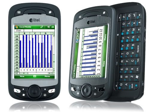

Now that I have finaly gave up on my old dependable Motorola E815 cell phone and replaced it with a pocket personal computer/cell phone, I am starting to think. Now that is a dangerous thing in it's self.
Our laptop is mounted in the Jeep. If we cable tether our PPC with unlimited internet to the laptop and to a cell amplifier/repeater, would it be more useful ?

There are actually multiple options for cell phone boosting. When Chris and I embarked on technomadism last year (as an internet software developer, I must have internet to make a living), I had a Verizon xv6700 as my cell phone that I used for tethering, which was a predecessor to your new PPC. (We also have an air card from Sprint.)
After a couple of nights of spotty coverage, I ordered a plug in cell phone booster from 3Gstore.com that works with both devices. (Having FedEx deliver to me at a campsite was mega-fun). There's actually an antenna jack right in your PPC that is likely covered by a small rubber nob.. and this thing just pugs right in there and generally boosts a bar or two - enough to stabilize a spotty signal. This eliminates the need to have a big amplifier built into your Oliver and a lot more affordable (~$70 vs ~$800).
The positive to this is that you can take your bandwidth with you anywhere.. you're not dependent upon being in range of your Oliver to get the boost. The negative is that it's not as powerful as a built in booster antenna, and you have an extra device to carry around and extra wires to contend with. Also, the boost only works for the connected device, whereas with the built in booster it amplifies all cell phone devices in the range.
