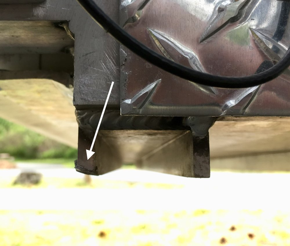

I have only dragged the frame one time on a steep paved driveway, but it was loud, jarring and a little frightening. Thankfully nothing was damaged except for the last frame cross support, which lost some material on both ends.
