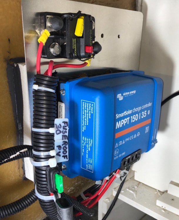

What Hull number? The earlier ones like mine (#218)  have no easy way to disconnect the panels, they used a self resetting automotive circuit breaker. You could replace it very easily with one of these:
IMG_9507.thumb.jpeg.8221d2219c2f30b7282ab235c3f49261.jpeg.3c5c3b10dd41b028f1b1863130cd8861.jpeg
Push the red button to disconnect power, reset it by moving the yellow lever back into position. Easy. I don't understand why Oliver cheaped out and used an inappropriate breaker, when they used that exact same part for the main DC bus, underneath the streetside bed.... Your fat black pair of solar wires should be visible coming down (from the Zamp controller in the overhead cabinet) to meet at that location. Just remove the existing $2 breaker and throw it far away, mount the Blue Sea one in its place. Here is a pic showing the one I installed when I changed controllers:
IMG_3379.JPG.e57ad8005ffebb2b5d203dd97c1d56f0.thumb.JPG.e637653d118cdb36b2a28ae02cb9efd8.JPG
