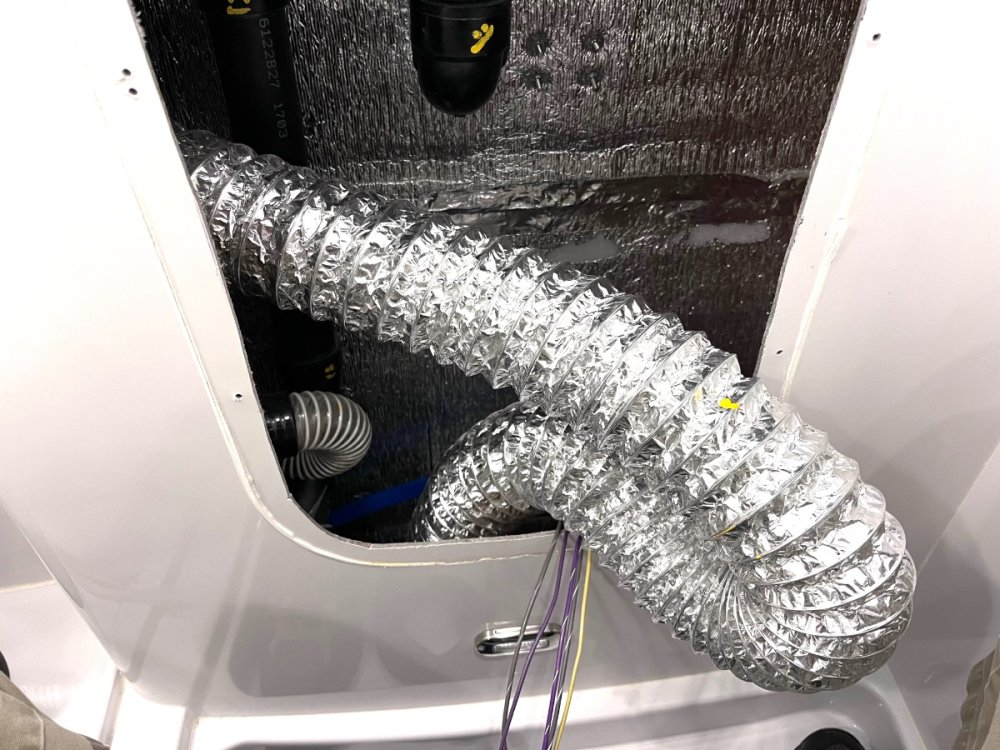

My compartment was a mess. Oliver used gaffers tape everywhere on my hull and it just doesn't hold. None of the wires were bundled or tied.
A large boa constrictor.

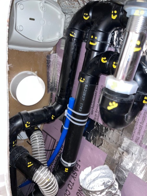

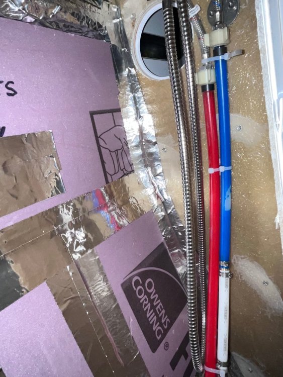

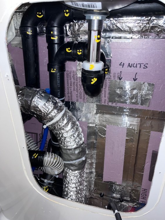

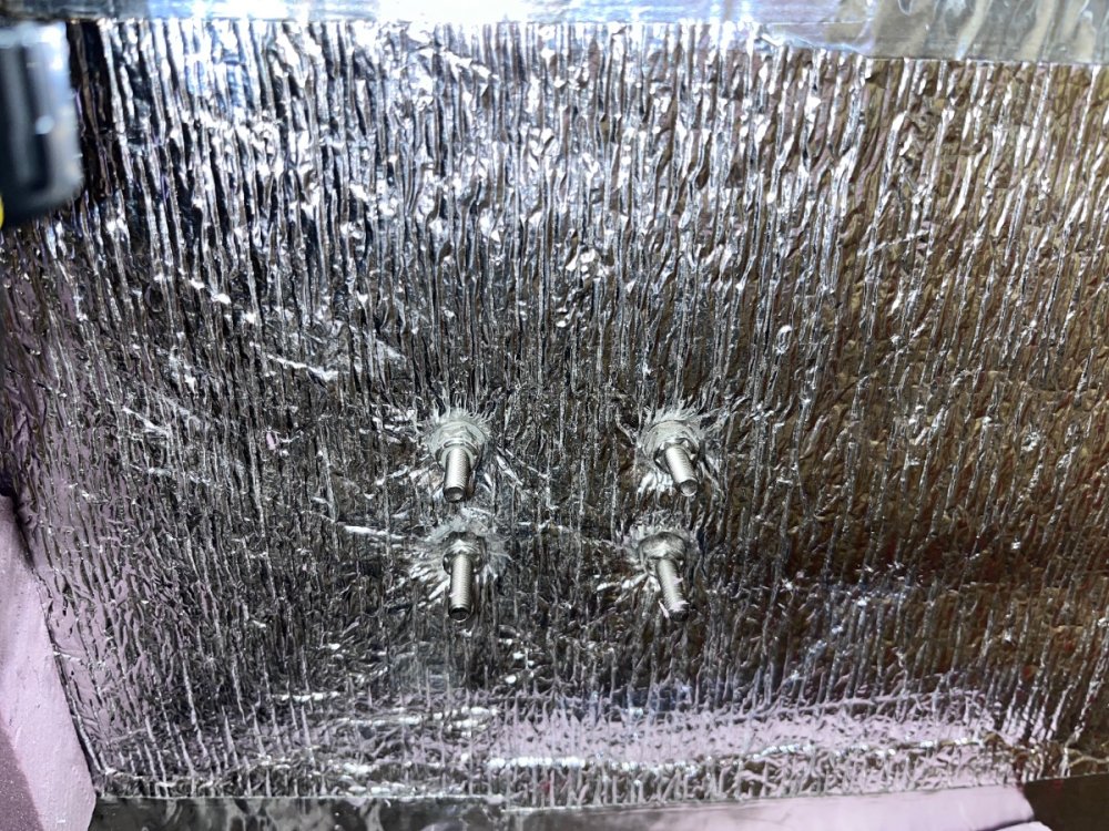

There was no insulation above the hull  join line, I fully insulated the front wall with silver bubble stuff and Dow Corning pink R5 (1"). I cut off the snake and added an adjustable 3" elbow. I cut off the unused toilet flush line and secured it out of the way. No more antifreeze in the face!
I wanted the cubby piece to act as an air return for the furnace, to suck air OUT  of the bath area when the door was closed.
My hull had an (optional) 5" inspection port in the closet do I can look at he plumbing, I turned it into an air return.

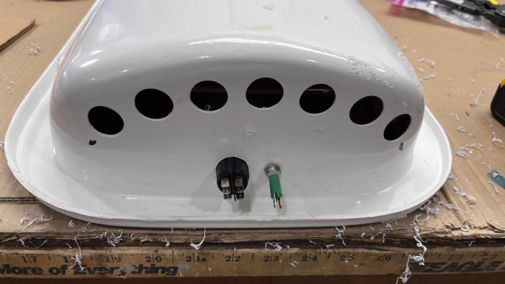

I took the round heating grill under the toilet paper roll out years ago, now the airflow is greatly increased!
