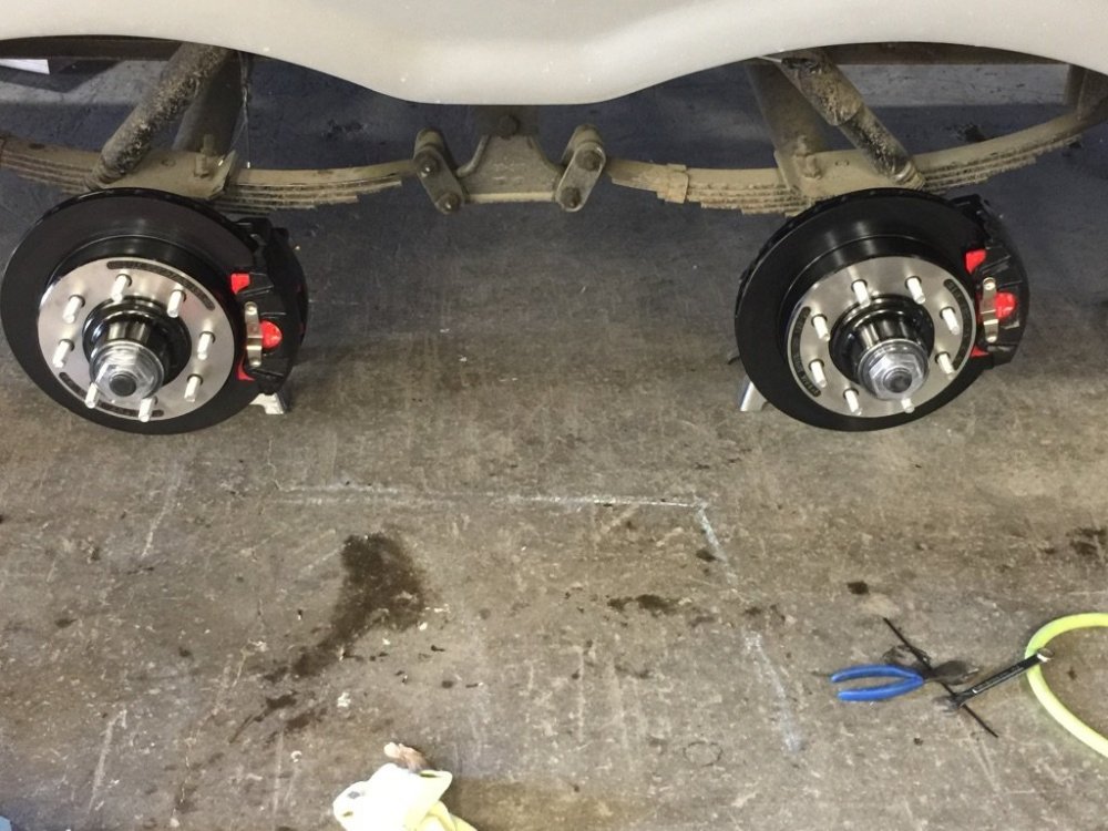

  1. John, I put disk brakes on my last two trailers and what a difference. I ask Olive if they would put disk brakes on my new Oliver without success, engineering had too many other projects. I'm going to do the modification myself (again) when I'm out in CA and can get my son to help. For me, the most difficult part is running the hydraulic lines from the pump to the brakes. Also, where to put the pump has not been determined. I don't remember if the pump can be mounted in the elements and that will be a mounting factor. Here are the desk brakes I mounted on my Arctic Fox. This was the easy part, next were the hydraulic lines. Bob

  4. Has anyone installed disk brakes on their Oliver? I installed them on my last fifth wheel and my last trailer before that. I'm assuming the Dexter axles can be fitted with new hubs, bearings, etc. It's not too hard to do it, just takes a little time. For me, installing the hydraulic lines is the most difficult part because crawling around under the trailer is a pita because of my age. I ask if Oliver would do it, but it's not on their radar screen yet. We pick up our new trailer in July and I don't expect the electric breaks to be around too long. If someone has already done this conversion, I'd be interested in knowing the part numbers. IMHO, electric brakes, even self-adjusting ones, are one iteration advanced over mechanical brakes on a Model A. Bob
