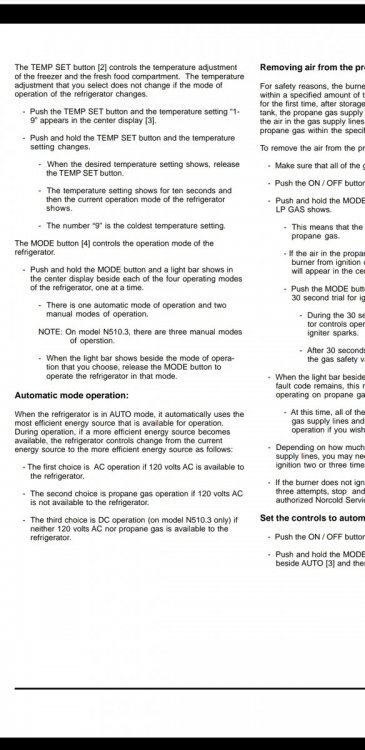

Bill, I was surprised, so I looked up the Norcold manual online. If his fridge is a 510, it will indeed switch to dc if neither 110 nor gas is available, unlike many other fridges.
That's not a problem if the gas is left on. It will choose gas if no 110. But, it's certainly something to be aware of for Norcold owners.
