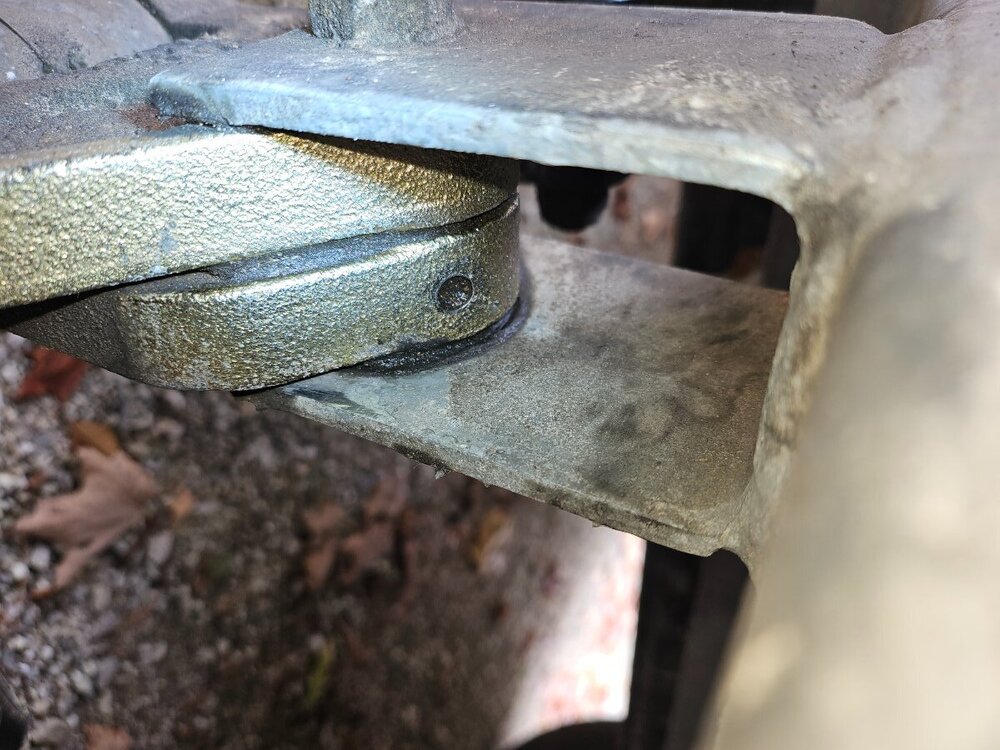

    Oliver

  2. Project/saga Update, Dexter Axle Company has agreed to provide me with two new replacement 13-144 equalizers at no cost to me. Shipment delivery expected next. Now for installation. Zerk correct tightness will be confirmed. End of story...I hope.

  5. Update and new plan. I have determined that two of the open holes of the three missing Dexter equalizer zerk have little/no remaining threads. Replacement zerks just slip in and fall out. New larger tapped threads would be required. So...the new plan is to replace the existing Dexter equalizers with new equalizers. I have no faith in the equalizer product on my Oliver. I have been in touch with Dexter and I am filing a warranty claim. Not sure how the claim will go, but new equalizers will be installed either way.

  7. Jd123 I have done a fair amount of auto/truck work over the years so this project is doable. At this point I am really trying to decide to lower the equalizer by removing the equalizer hanging bracket bolt OR remove the leaf spring connection to the equalizer to lower the equalizer. Your thoughts?
  8. One last question to all who have been so helpful. Should I release the leaf spring shackles on one side of the equalizer to drop/lower the equalizer to install new zerks? OR Should I remove the equalizer hanger bracket center bolt to drop/lower the equalizer to install the new zerks? (I am still going to try to install the zerks without lowering the equalizer...but I know that likely will not work.) Thanks to all.
  9. ScubaRx While cleaning the area today I thought when I have the parts I would give it a go without dropping the equalizer. Previous comments made that sound impossible...but still will try. Still flexible with long fingers... You recommended not disconnecting the leaf springs but rather just the center equalizer bolt. Sounds good. Have you done this? Has anyone else?
