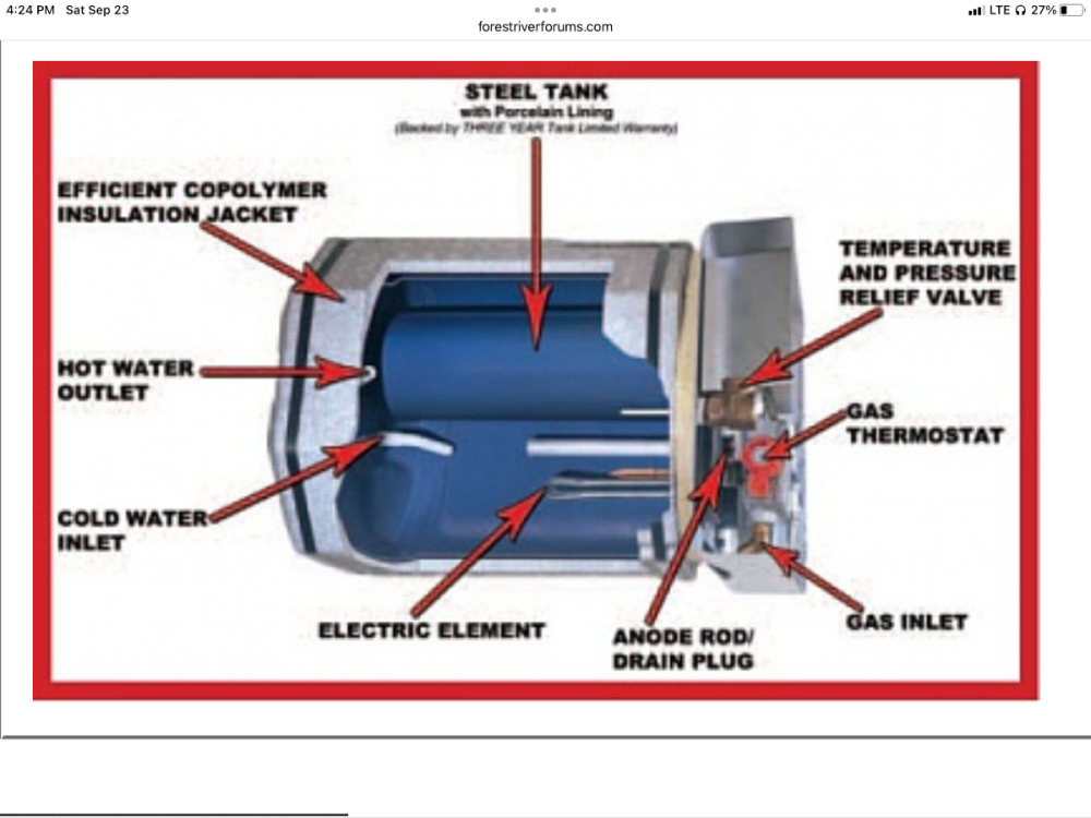

  2. Hi, On my second big trip with my 2018 LE2 trailer. My hot water is just warm enough to shower with. I have a Suburban hot water heater and it runs fine. I crack open the pressure relief valve and the water is very hot. Running the hot water in the sink it is only slightly warm. My valves are configured correctly around the pump etc. Before we left home I changed the anode rod and flushed the tank with a homemade copper wand. After some research I might have broken or dislocated the cold water inlet “dip” tube with my wand I’m speculating. The attached graphic shows how this could easily happen I believe. This I suppose might allow cold water to better mix with outgoing hot water. So in summary what are thoughts about my conclusion. And how in the heck does one fix this tube seeing that it is inside the tank? Thanks.
