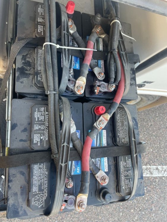

Thanks! Can you say where in the below picture I should connect if I ever try this? -
Our 2019 Elite Legacy II trailer - which we bought used - is probably pretty unique - it has just about everything anyone could want - but no inverter. After hooking up Starlink the lithium batteries in the van died. I revived them with the car battery and ramped down the energy usage and the batteries appear to be restored. My question is would it have been or is it possible to attach the Bestek 400-watt inverter to one of the batteries in the battery pack of the Oliver and get some energy out of it while the lithium batteries in the van were being restored (by the solar panels) ?
