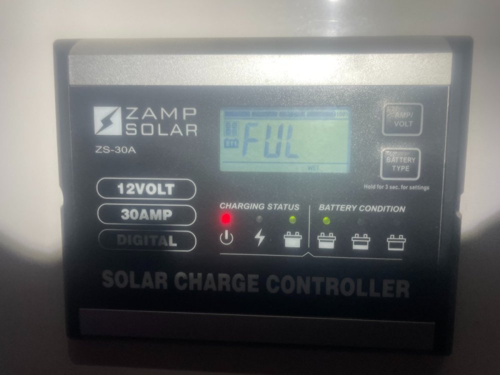

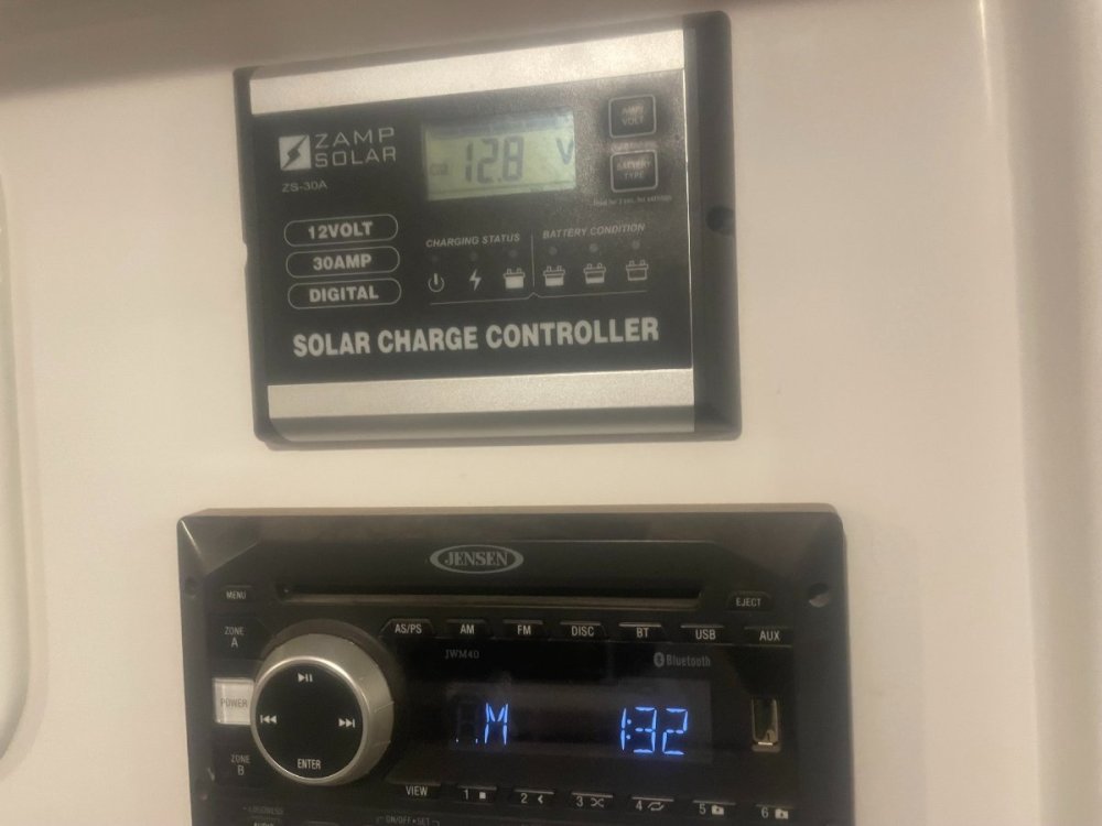

Thanks - we learned that they did sell us a wet cell (Electric World) - the guy just neglected to tell me that. That was curious because when I gave him a wet cell battery and he gave me what looked like a dry cell battery (no water cells on top - they were hidden), I specifically asked him if it was OK to combine wet cells with AGM's - and he said yes and that was it. When we took it back today we learned it was a wet cell after all.
Interesting - the new battery tested poorly but was accepting some charge - and we'll see if it able to charge fully. (Battery plus thinks it was probably a bad battery - we'll know by tomorrow. It's an Electric World from Camping World. Today the new battery was almost completely shot while the old batteries were down to 4.10 (by voltmeter) so it may have been dragging them down. That's our hope anyway. Since, we are burning dollars staying at a hotel we elected to buy a set of new Interstate batteries and go from there.
We are on a trip. This was actually my partner's first exposure to the Ollie. She arrived for Toronto, we stayed in a hotel for a couple of days, the dog got sick - we stayed some more and then on the day of our departure I went out to the Ollie to find the batteries dead. Nobody has any explanation for the high voltage readings. Oliver said the batteries would be bulging at that charge and lo and behold when we removed them they read 4.10V and our new "AGM" battery - which turned out to be a wet cell battery after all (it just looked like a dry cell and the guy at Camping World neglected to tell me it was a dry cell after I asked him if it was OK to mix them) was almost dead. Back to Camping World we went where they suggested that we try to recharge the new battery. We took it to Battery Plus - they said the battery was very low - was probably no good - and are seeing if it will charge properly. We didn't really feel we got good advice at Camping World so we talked to East Valley RV in Phoenix area - liked the guy we talked to - and bought 4 wet cell Interstate batteries there. We will try them tomorrow and see what happens 🙂
Good question. Thanks. The batteries are wired correctly - I took pictures before and after and they match up. I checked the volt meter on the car battery and it read 12.89 so I assume its reading correctly. Camping World says not to mix AGM and Wet cell batteries in part because the controller is set to one or the other - and it now has both. They recommend that I replace all the batteries with AGM.
Things have taken a turn for the worse. After consulting with Oliver I bought a new battery from Camping world - same power output etc - but an AGM - I was told by Camping World that it was ok to substitute an AGM for a wet cell. The power came on but this morning all 4 batteries are dead - and all now read the exact same voltage (241.0 V. I put a ticket in with Oliver and am consulting with a Camping World nearby.
