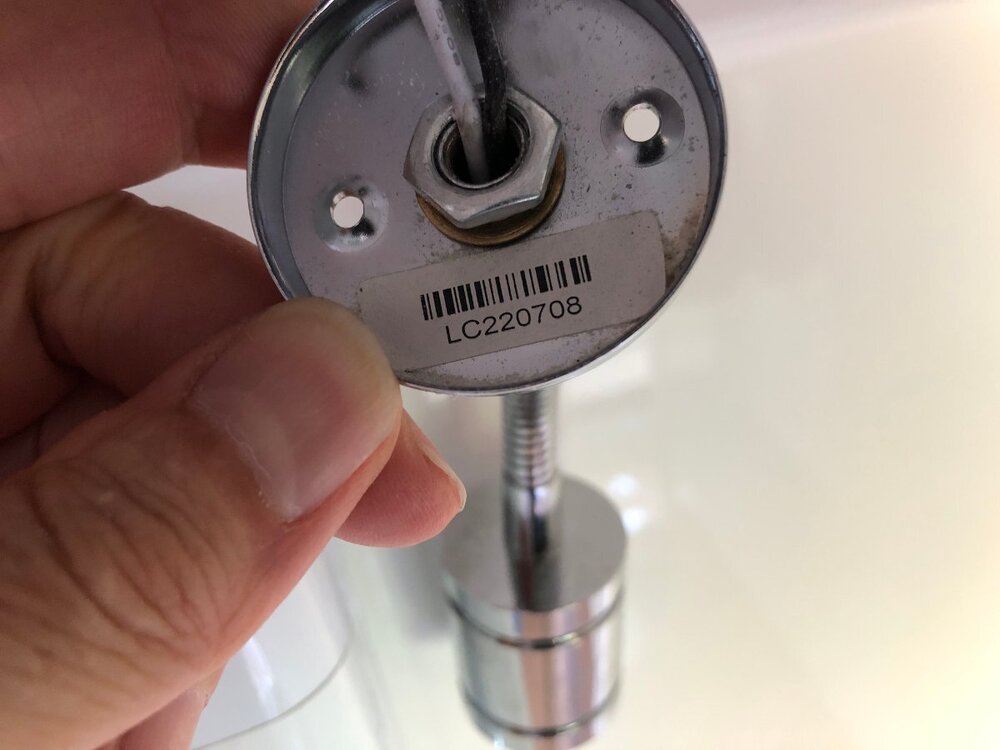

  1. I am posting this in case anyone else has the same problem. The gooseneck on one of my reading lights came loose. The flange is attached to the ceiling with two rivets. I drilled out the rivets with a 1/8” drill bit to get access to the lock nut that holds on the gooseneck. I removed the lock nut, coated the treads with Blue LocTite and re-tightened. Then simply reattached the flange using 1/8” diam x 3/8” long rivets. Problem solved.
