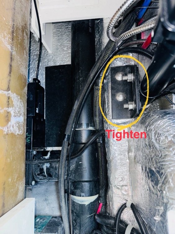

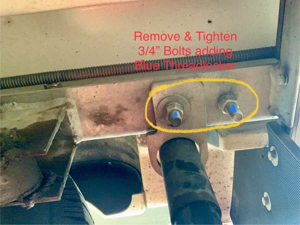

At the eclipse meet up I was asked about tightening the stabilizer rear jacks.
i use blue threadlocker to help with bolt retention.
Spec: 3/4”  Leveling Jack flange bolt nuts (43 ft-lbs).
Bolt locations shown for rear.
inside :
outside:
