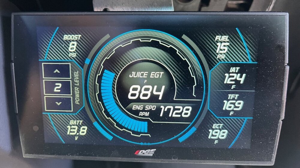

It appears you found a great cooling mod and love you gauges. I was never into gauges on vehicles past but went full route on our Ram which already had a trans cooler. I wanted to keep eye on all relevant temps while towing. Also, the 2nd gen Ram 5.9 Cummins in OEM form is quite detuned, so I also added a tuner for more power. Program #1 adds MPG efficiency when around town. Program #2 adds power for towing (amazing climb on this mountain road), and programs 3-5 are for the crazies that run at tractor pulls (I never use the extreme programs).
The Edge Juice w/ Attitude included the tuner and all the gauges and a quality 7" display. TFT stands for Trans Fluid Temp, IAT is Intake Air Temp, ECT is Engine Coolant Temp, and EGT is Exhaust Temp (important to be <1200F when running hard or on tune programs). First need on a Cummins Diesel is to maintain 14 PSI in fuel pressure. Love this setup for towing power and monitoring vitals.
This picture was captured towing our Oliver (I asked Chris while I was driving), a mild climb just south of Hoover Dam on N Hwy 93. It was high 90s outside and at 1728 RPM, I was likely driving about 65 MPH in OD. I have never seen numbers over 200F. Obviously, these are different designs in transmissions. The highest temp I've seen was 193F. Not while towing but due to the climb from Parowan UT up to Cedar Breaks NP, a 4000+ FT climb in 20 minutes.
