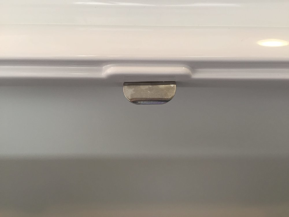

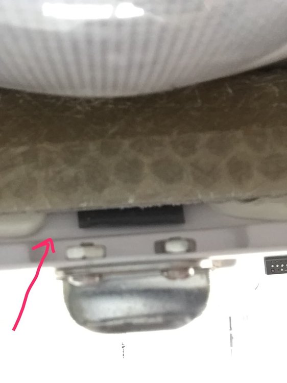

I took some pictures of the upper cabinet latch. I don't have a spacer in mine. The second picture is looking for underneath. Is this where you have spacers?
