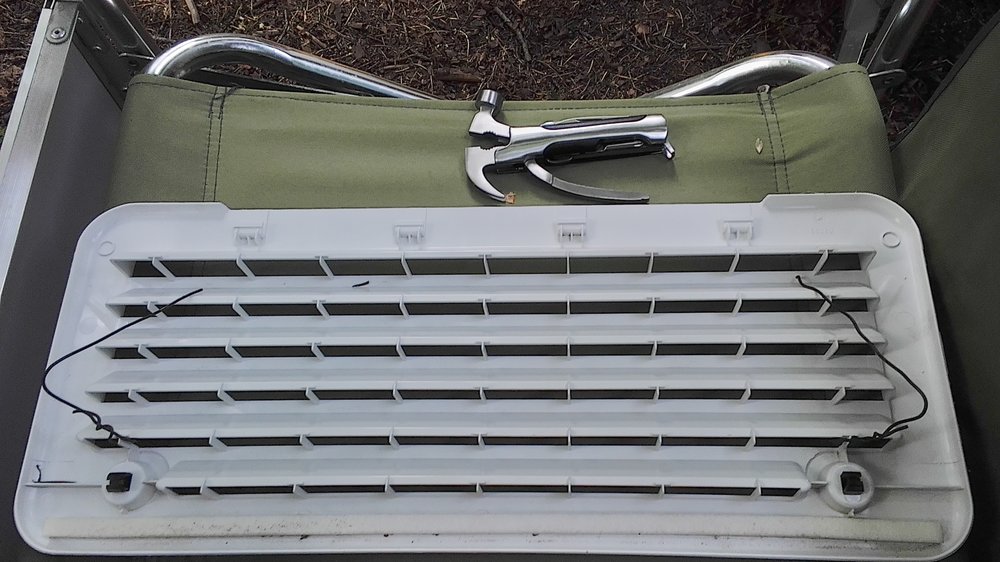

Larry Gamble of Little House Customs came up with a great idea a few years ago for the Casita's that doesn't run a fan to keep the fins cool. While we were at the Rally in King City, CA. I noticed that our fan wasn't shutting off at all during the day, so I pulled off the cover and it was really over heating in the sun and it was no longer keeping up with it being on AC and on the 3rd setting. So I grabbed the roll of rebar wire out of the tool locker and used Larry's basic idea once again, but on Goldilocks this time.
When boondocking, we don't want to be running fans all the time when they really aren't needed. The fridge door vent, after you open the locks leans out on its own a few inches and this is all it takes to vent all of the heat directly out and away from the fridge. So I cut a couple pieces of the wire about 6" long and made the holder to keep it in place. Now the fridge fan doesn't come on and run down our batteries at all :)
You can see how I slip the wires through the lock holders and then just bend them down to firmly hold it in place.

Then before we leave, I pull the wires out of the locks and push them inside and out of the way of the fan. Then close and lock the Vent Cover normally and leave the wires stored inside and unseen behind the Vent Cover.

Reed,
Simple and affective mod.  Good job.  BTW, I like that combo hammer, pliers, etc. tool in the picture.  What is that?

Reed, Simple and affective mod. Good job. BTW, I like that combo hammer, pliers, etc. tool in the picture. What is that?
Hi John, we picked the hammer up over on the coast at a little gift shop for $20. It's built really well for the price and I didn't want to carry a tack hammer just for putting the plates on our walking sticks, so this filled the gap. I found them on Amazon but I would contact the seller or the gift shop where hwy 1 was closed on the south end and buy it from them,
