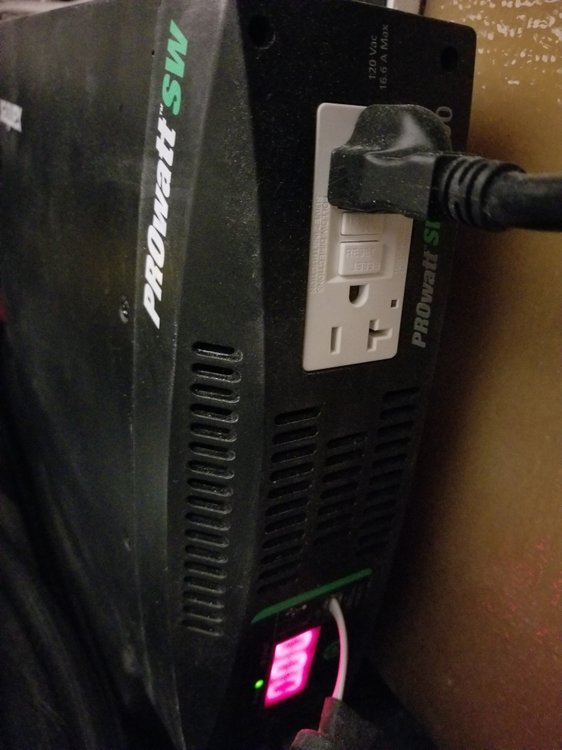

Finally got "unplugged". Today was first day to really test out the solar. Was so impressed!! Then this evening see that the IPN ProRemote backlight is on for some reason although I haven't been touching it.  Check it out and it has crazy various numbers and symbols scrolling.
Symptoms. =
*Dark outside - ProRemote  showing various hieroglyphics. Also charge status light vacillating between acceptance and bulk.
ProWatt SW - light has been on for the last couple of days and it won't turn off when I push the button.
Blue Sky Solar box under seat - No lights when red knob in on position. Also the Progressive Industries box shows no light/numbers.
PROwatt SW box under seat - Does show numbers 130 & 000. I can turn this box of and the prowatt indicator on the wall will also turn off. When I turn the box under seat back on the lights for both come back on. ... but I still cannot turn off the button on the wall.

Carole,
Try unplugging the back of the blue sky box. You will need to unscrew the panel and then unplug a telephone wire from the back.  Leave it like that for about a minute and then plug it back in and re-install.  I had my display go blank and that's what blue sky advised.  It did fix the problem.

Turns out I needed to replace the IPN remote unit. Ryan at Blue Solar got me all fixed up!
