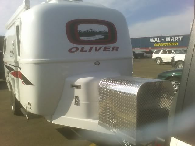

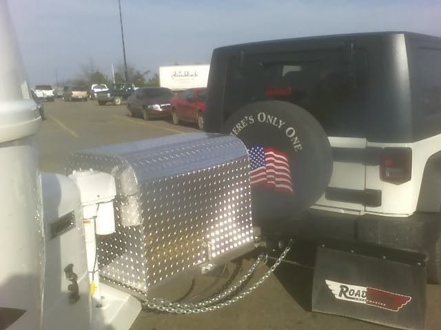

A different look. Butcherknife went into W/M to get a jug of milk, and I took this photo:
Ok, I admit that I don't know exactly what I am talking about... but won't that add too much weight to the tongue for the jeep to pull safely ? You got to remember I got the Casita Club phobias drilled into my psyche! Nothing against them, but I remember so many posts about adding weight to the tongue..... is Oliver that much safer ?
Geri
Geri this may seem controversial, though not intended to be, but, the short answer is yes. The tongue on the Oliver will extend out two feet further by virtue of it's extensible abilities. My adding the generator box is not the factory's solution to adding a generator. The factory has discussed several ways to add a generator, but they nearly all go in front of the propane tank cover. The factory is making bugeyedriver's generator "basket" so that it will have some extra storage there, if I understand it right. Maybe Pete can help us out here. I have went out on a limb a bit here, but it is two hundred pounds fully fueled with 2.5 gallons of gasoline. And it tows just like it did on the Arizona trip last week, without the generator mounted on the tongue.
The cool thing is that it uses the existing two adjustable holes in the tongue to bolt it on. Should something unforseen arise, then it is a simple matter to just unbolt two bolts and set the whole assembly, generator and all off. Which would return the Oliver to the way I have been towing it for a couple of months while anticipating the arrival of the generator box. When I check the bubble level on the tongue jack, I find that the bubble is still centered when sitting level and when I stand back at a distance and look, everything is in a straight line.

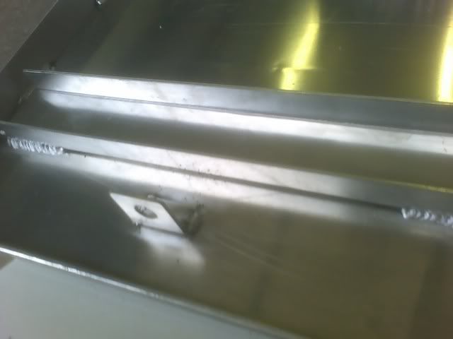

The top view of the saddle/mount, with the cover latches in place, before the wheel channels are installed:

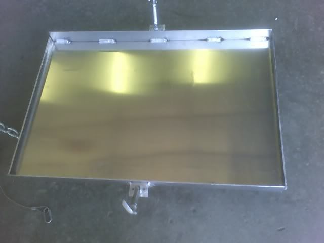

Bottom view of the saddle that straddles the tongue, with the mount on it:

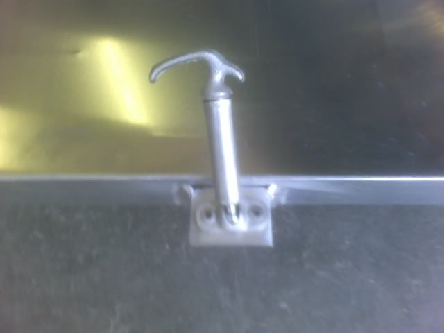

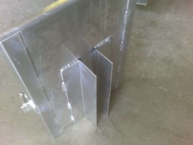

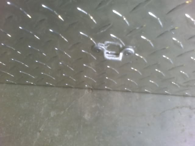

Both halves of the cover latch:

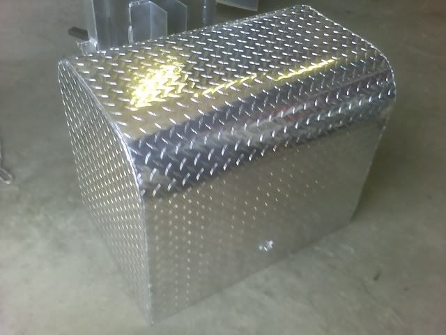

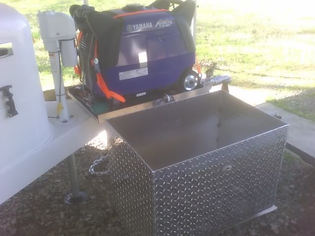

The cover:

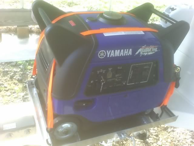

The Yamaha 3000 sits in place for the first time, to measure for the channels that the wheels sit in.
With the wheel channels in place, one of the cable lock brackets is installed:
The cable lock will deter theft when the cover is unlocked and off. When the cover is on there will be locks on it also.

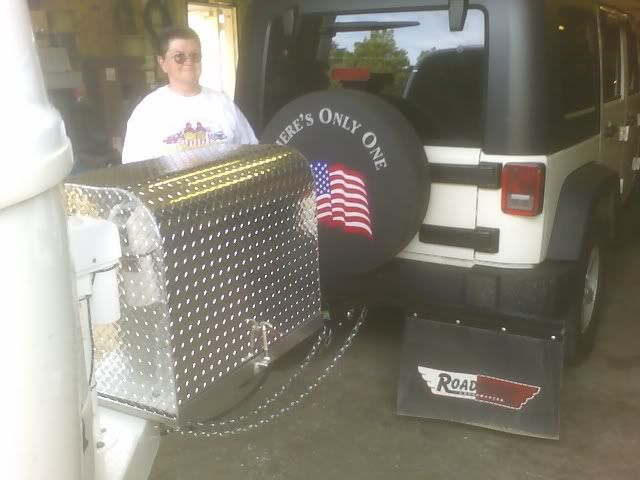

Generator installation completed, we are hooked up and ready to test pull for the first time:
Just look at butcherknife's grin ! Boondockin' here we come !

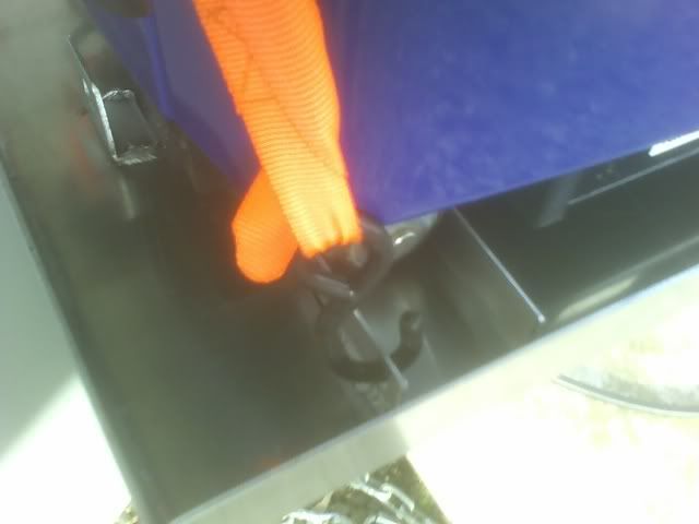

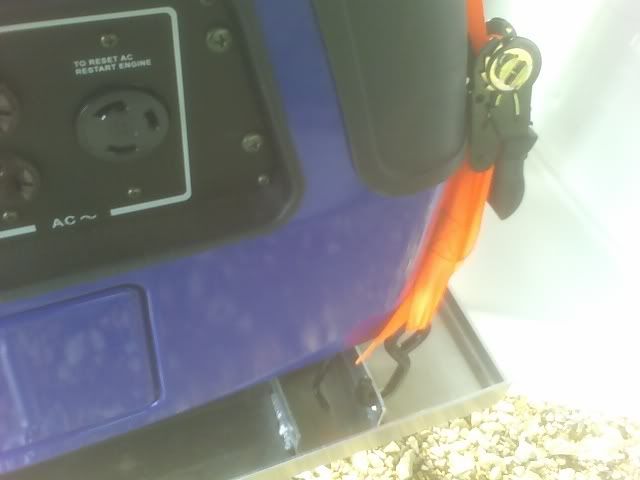

Overview of the rachet strap tie down system :
Rachet strap close up:
The straps were fifteen feet long. Now the excess is cut off and the ends seared to prevent fraying.

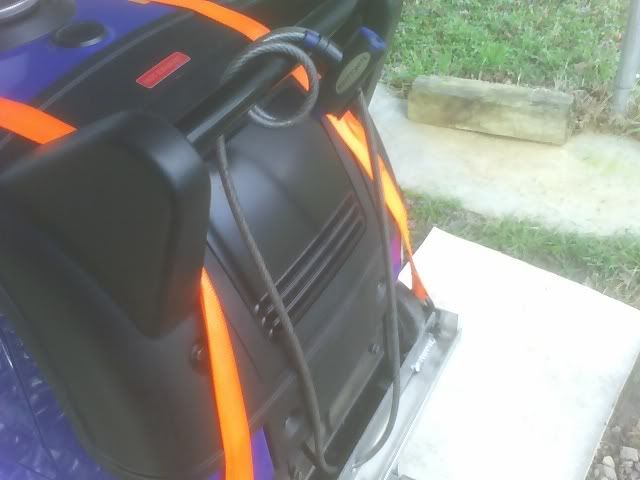

Kryptonite cable lock through the gen set handle and the mount. There is one on each end of the gen set:
The Yamaha comes with a spark plug wrench, ect., so we left a small amount of room at the rear, by the rear cable lock bracket, to store small gen set related items where they will be handy if needed.
The cable and lock are covered with either plastic or rubber to be more gentle on all surfaces:

Try to secure the generator without incorporating the HANDLE. The handle is easily cut with a bolt cutter(not sure on 3000 but 2400 & 2800 and Honda 1000-3000 have been stolen by 2 cuts of the handle at Quatzsite and chain still locked together!!! :twisted:
Chuck 8-)
Thanks for the heads up on the handle :o , I'll work on that one some more !

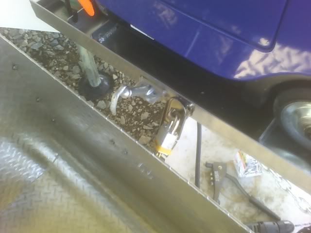

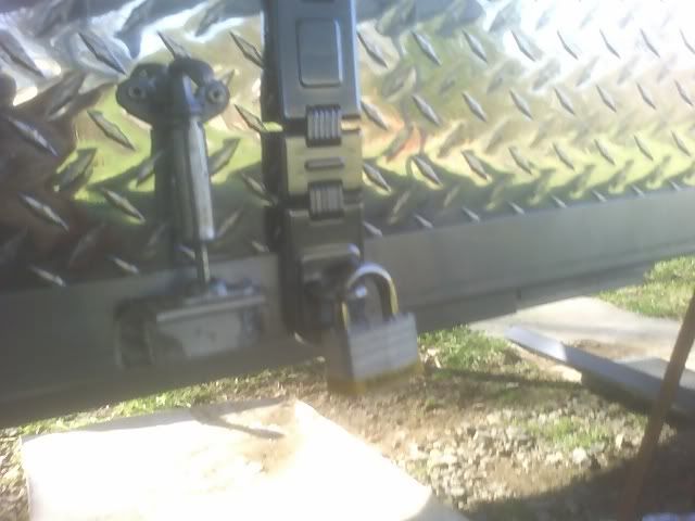

Hasp and padlock added on each side of the generator cover with keyed alike locks.
The aluminum cover is so light that it could easily blow away even in a fairly light breeze, so, securing it so it can't get away goes like this, set it on the ground right beside the generator:
Then flip the double jointed hasp over and lock the cover back to the gen set mount:
