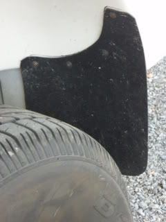

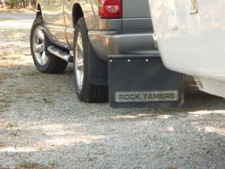

Moderators SeaDawg Posted September 19, 2008 Moderators Share Posted September 19, 2008 A member sent me a pm asking me to post photos of our mudflaps, so here goes: This is a photo of the small mudflaps that Oliver installed for us on the trailer wheelwells. And this is a photo showing the removeable mudflaps mounted on our pickup. These flaps are mounted to a bar, not the truck, and mount to the receiver, so that we can take them off when not needed. We bought ours from Costco, online (we're not members... you can order online without a membership) for about $180. Also available from other sources, at a variety of prices. If you look carefully at this photo, you can see the permanent, smaller mudflaps we had installed on the truck for the days we don't use the big Rock Tamers. 15,000 plus miles now, and no chips yet! Sherry Sherry 1 2008 Ram 1500 4 × 4 2008 Oliver Elite, Hull #12 Florida and Western North Carolina, or wherever the truck goes.... 400 watts solar. DC compressor fridge. No inverter. 2 x 105 ah agm batteries . Life is good. Link to comment Share on other sites More sharing options...
Moderators SeaDawg Posted November 6, 2008 Moderators Share Posted November 6, 2008 An update on the Rock Tamers. We got a new truck a few months ago (a Ram 1500), and our old Rock Tamer flaps are now too short, as they were trimmed for the lower Silverado. I found out that replacement flaps can be ordered from Enkay in Colorado for $30.00 each (black) or $45.00 each (chrome), plus shipping. You don't have to buy a whole new Rock Tamer system. Note: I tried contacting Enkay (parent company) by internet, but didn't get an answer for several days. Phone calls are answered promptly. 800-545-1894. The whole Rock Tamers system is still much less thru Costco online, or Cabela's, than by ordering direct. Sherry 1 2008 Ram 1500 4 × 4 2008 Oliver Elite, Hull #12 Florida and Western North Carolina, or wherever the truck goes.... 400 watts solar. DC compressor fridge. No inverter. 2 x 105 ah agm batteries . Life is good. Link to comment Share on other sites More sharing options...
