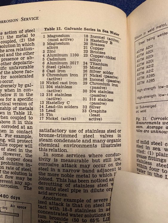

I haven’t seen any issues with the Andersen steel frame brackets or with the Oliver galvanized steel subframe for the suspension causing any problems with the Oliver aluminum frame (yet).  Steel, zinc and aluminum are all pretty close to each other on the galvanic series chart, which means minimal galvanic reaction (but not zero).  This is from my good old metals handbook.  The farther apart two metals are on the chart, the greater the galvanic corrosion reaction.  This is seawater exposure so pretty much a worst case, but road salt & moisture would be just as bad.  The order can change a little depending on the exact environment.   As an example, 316 stainless against aluminum is very bad.   And the lower number metal becomes the sacrificial material in the pair.   It’s why zinc is used as a sacrificial anode in a lot of systems with dissimilar metals and water, like boats and water heaters.  A dielectric material barrier between the metals helps, even a layer of paint.  And if the aluminum is anodized, that helps as well.

Where would aluminum 6061T6 fall on that chart? I think this could be a real problem if you tow in winter over salt or mag chloride treated roads. Oliver uses plenty of 304 stainless fasteners like self tapping screws all over the frame and I have never seen any issues. I also haven’t seen any degradation of the anodes. OTH I neither tow on wet roads (except when it is unavoidable) nor in winter. I think it would be a good topic for long term monitoring from those owners who use their rigs year round, for skiing especially. But IMHO those units will be suffering from far more extensive damage to the frame, running gear and exterior steel fittings than a little localized dissimilar metal corrosion. I have only seen underneath one such (admittedly neglected) Ollie, and frankly it was a disgusting mess. I don’t think the factory would offer a five year frame warranty if they felt it was not durable, but maybe they would consider prolonged caustic chemical exposure to be abuse...
I'll have to dig a little deeper but most of the galvanic charts just lump all "aluminum alloys" together, so 6061 probably isn't much different, close to steel and zinc.   The use of a stainless screw threaded directly into the aluminum frame could be a long term issue if towing on salted roads in the winter.
