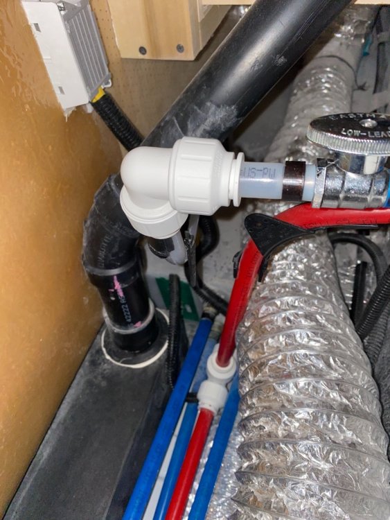

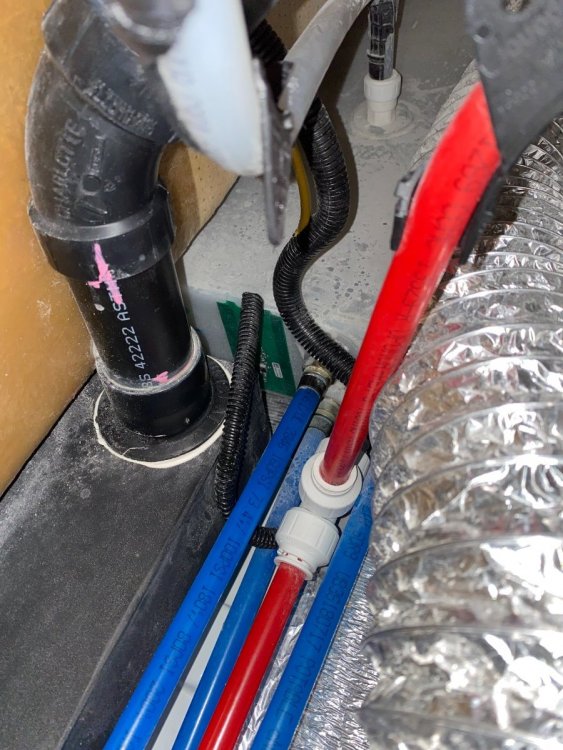

The fresh water tank can be seen if you lift the access hatch closest to the stove under the curbside bed.   The fresh tank is the translucent low flat tank.  Part of the gray water tank can also be seen there.   The level sensor is a small green circuit board mounted on the end of the fresh tank facing the back end of the trailer.   Just happened to have mine open for de winterizing.
