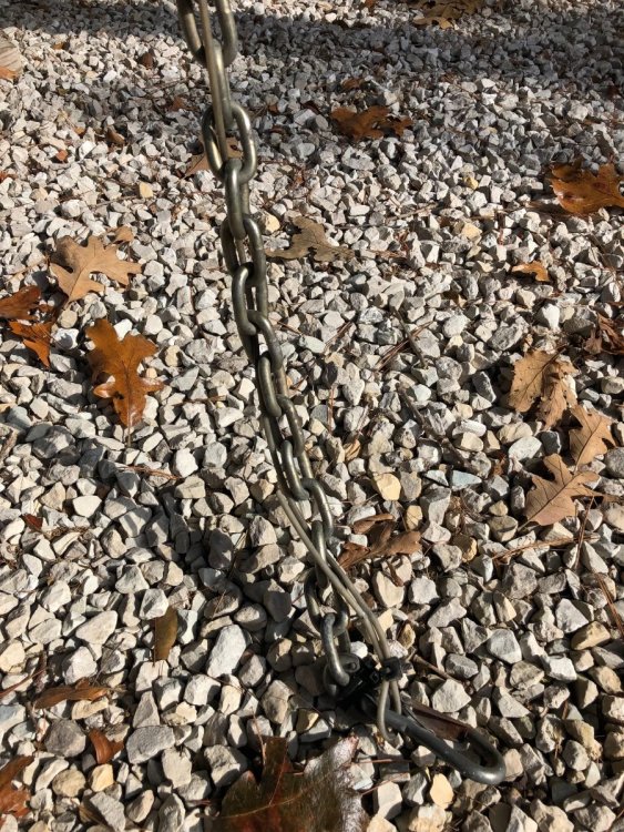

mokid Posted October 24, 2021 Share Posted October 24, 2021 We bought our Oliver used and the previous owner has the Emergency Break Cable threaded through the safety chain. To me this would be useless as it would not apply the breaks in a break away. All of my other trailers I hook up the break away cable separate. 1 Link to comment Share on other sites More sharing options...
Frank C Posted October 24, 2021 Share Posted October 24, 2021 That configuration is definitely wrong. The emergency breakaway cable should go directly from the breakaway switch on the trailer to the tow vehicle, usually attached to one of the slots or metal loops on the hitch receiver on the tow vehicle. As yours is currently configured that would likely do absolutely nothing to activate the trailer brakes if the trailer came unhitched. 1 2019 Oliver Legacy Elite II - Hull #461 Tow Vehicle: 2019 Ford F-250 SuperCab 4x4, 6.2L Flex-Fuel engine Link to comment Share on other sites More sharing options...
mokid Posted October 24, 2021 Author Share Posted October 24, 2021 Thanks, that is my thought exactly. Link to comment Share on other sites More sharing options...
